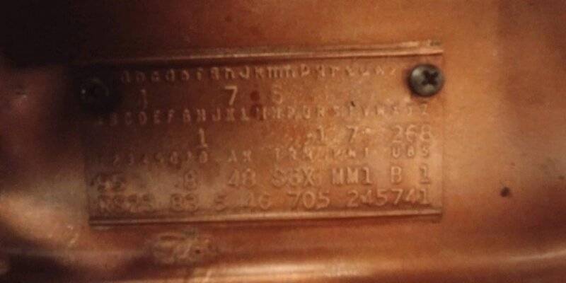

Can someone please decode this fender tag for me?At least what you can make out?Also this is a 1968 GTX and would it have the numbers on radiator support,engine,and trunk lip?

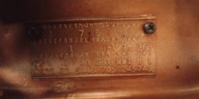

Nice....turbine bronze, 440/727, F70-14 redlines, pretty late car. July 5, '68. 245741 should be on the rad support and trunk lip. Last 8 digits of vin should be on the top rear of the block near oil sender and top front of trans case.
