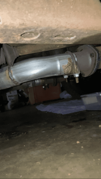

I have a ‘68 440 with long tube headers. I’m needing help with the pipe degree dimensions to get thru the trans crossmember and then the exhaust be parallel to the frame/driveline.
The current hack job i have now, the guy used two 45* elbows to clear it, but its not enough for the exhaust after to be straight, he even mounted the muffler crooked to get enough angle to go over axle.
Anyone have experience with the needed elbows for making self fabricated exhaust? Thanks.

You wont get there with slip together parts. I buy bends and cut and weld what is needed. It's actually very easy to but weld exhaust pipe with a mig.
Doug
Thats my plan Doug. I have a welder, i just wanted to see if anyone knew the length and degree of pieces i needed. I figured many guys had been in my current shoes before.
Maybe a 45-90-45 or 30-60-30?

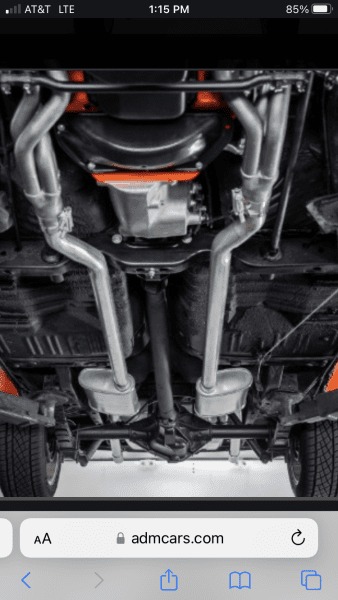

I found a picture of what i want mine to look like. Appears to be two 3 inch radius 45* bends. The crap on mine is two 4 1/2 radius. They overshot the angle and tried to bend it back. Ended up a mess that im taking all out. Hope this post helps someone!
