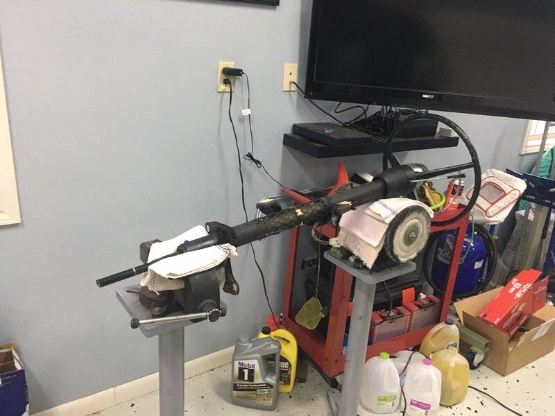

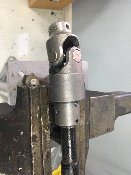

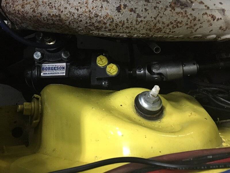

I purchased a 1968 Plymouth Road Runner a couple of years ago. The incentive was mostly because my wife and me purchased a 68 Road Runner new as our first new car. This current project has exactly the same equipment as our original - nothing! It's a 383 4-speed with a 323 differential and nothing else. After taking it for a drive I was quickly aware that I'm not as stout as I was at 21 years of age and figured I first needed to upgrade the steering. After doing some research I purchased the Borgeson 14-1 box, pump, pulley, and the universal joint needed for the steering column modification.
The upgrade went smoothly and works very well. My only complaint with the steering is that I still have the large diameter stock steering wheel and it's somewhat cumbersome to drive. I'd like to find a stock appearing steering wheel that's about 15" in diameter, which would complement the new power box.

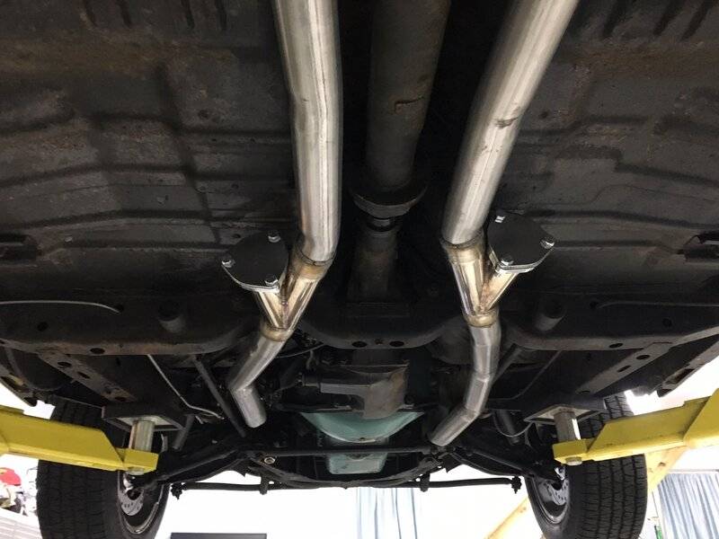

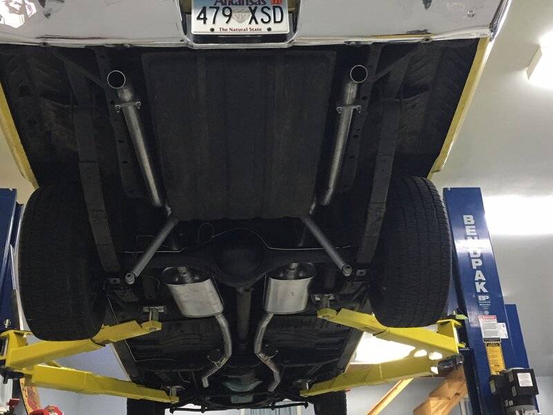

The next project on my list was to replace the old and worn out exhaust. I chose the Walker Super Turbo Dynomax mufflers with the 2 1/2" inlet/outlet sizes. I had Batesville House of Mufflers (Batesville, AR) bend up and weld the pipes and also install some cut-outs for future electric units. They were very reasonable and their workmanship was excellent.
