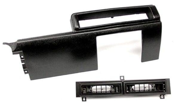

I’m putting a Vintage Air kit in my 1969 Super Bee. Of course, it’s a non a/c car, so the vents in the center will go under the dash.
I came across this dash panel and vents on Classic Auto Air. It’s for a 1970 Coronet. Classic says they don’t think it would work for 1968 or 1969. Looks to me like the dash is the same. At least the center section. This would allow for a much more factory look, rather than vents below the dash. What do you guys think? Would that work?
It Won’t work, 1970 is one year only hard plastic. 68-69 is soft padded vinyl covered.
This goes for all the dash pieces and the Glove box door.
you need to use all 3 pieces from a 1969 car. Yes it would look better than underdash vents.

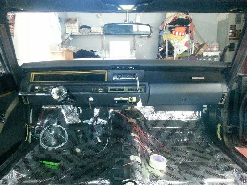

i cut my dash to fit the vents in where the factory did
