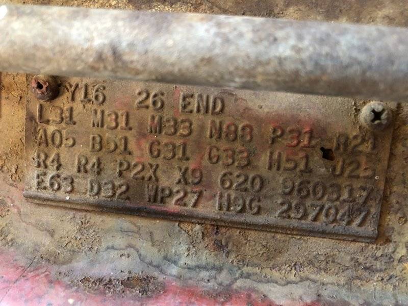

The 69 B body 383 (E63) auto (D32) with A/C (H51) is the 899 assembly. N88 Auto Pilot doesn't affect the carb selection.
You are looking for carb 38 or the Holley R4440.

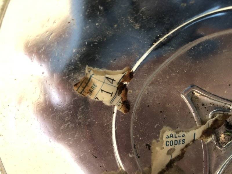

I found remnants of my broadcast sheet. The last character of my carb is a 1. Per Doug this is 91. Is that the Carter 4638SA? Thanks all for helping.
91 is only 1969 choice. Apparently either carb 4616 or 4638 would be supplied for that pn. A/C being the determining factor.
