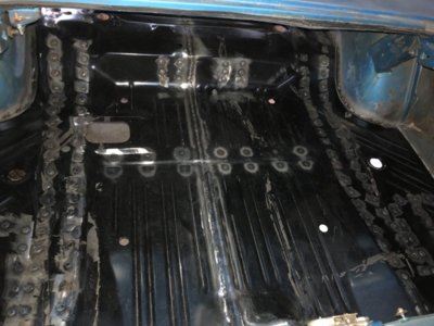

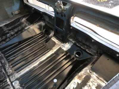

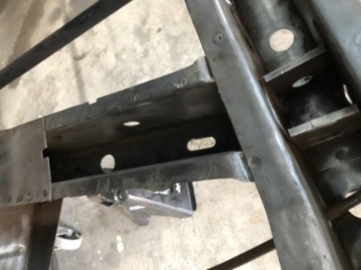

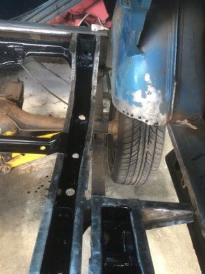

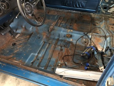

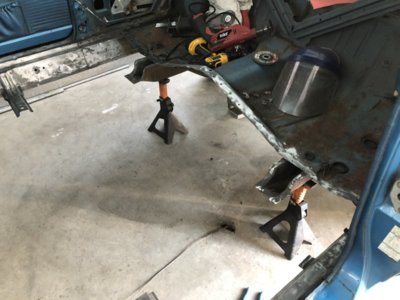

Hi guys. I’m new here, but wanted to share about my car and where I’m at with it. It was a slow start to get going on this charger. I’ve had it for about four years now. Shortly after buying it, I told my wife that I was ready to try to have a kid. With that being said I wanted a house of our own. So the car stuff was put on hold. I sold my 65 D100 and 63 valiant wagon and we bought our home with a two car garage. One spot for my charger and one for her metropolitan. Shortly after moving, we found out she was pregnant. So for the next few months I spent my time getting the house ready for when my son was born. He just turned two and things are starting to settle down enough that I’m getting out in the garage again. So far I’ve pulled the engine and transmission out of the car and replaced the trunk pan. Right now I have most the floors out an am cleaning up inside the frame rails for paint before I weld the new floors in. Progress may be a little slow here and there since things are pretty busy around here. But I look forward to sharing my progress with everyone.
A55B3563-9334-4CA6-B70E-C33D4DB783CE.jpeg 41C2720A-7874-4E0D-A651-D9BE60132B63.jpeg CA1C9753-AD81-472B-A332-7A87C89BC3C3.jpeg 60BDEB69-DCEA-4CFC-89E0-C9038E8AB2E6.jpeg 774DCA23-1ACB-4396-A458-FD4E169BACDD.jpeg 45DF5305-06AE-4B8B-873A-588042945C08.jpeg 926E6BF8-68E5-4FEB-9DA4-9665F7A724E1.jpeg

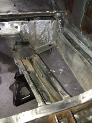

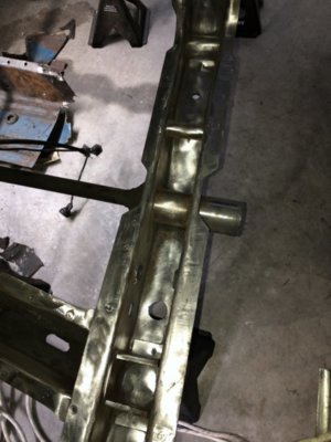

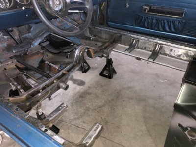

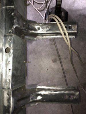

Here are a few more of the floor pans. The floors weren’t too bad but I wanted solid metal for the uscartool subframe connectors to weld to. The insides on the frame rail were super clean!

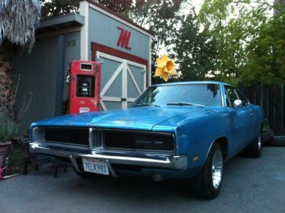

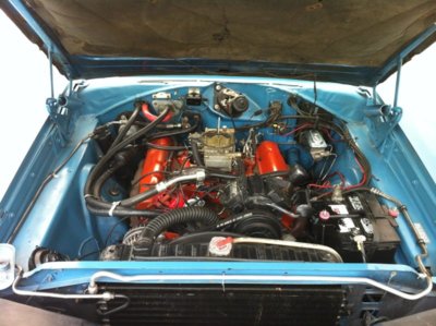

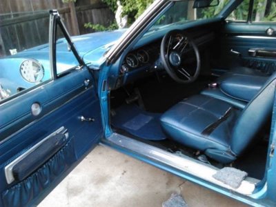

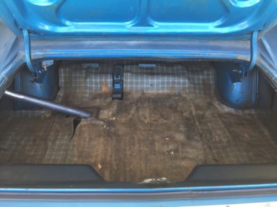

Thanks guys. One step at a time. I’m in Brentwood ca. Here are a couple picture of the car when I bought it. It ran and drove, but needed everything to be gone through. I figured I better just take it apart and go through everything and make it right vs. have problems all the time and be frustrated with it.

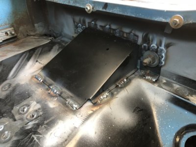

Not too much fab going on here. Just cleaning, prepping, fitting and welding AMD sheet metal. But thanks. I learn from reading articles on the subject and looking to see what others have done. I took welding classes at a local college when I wanted to learn to weld.

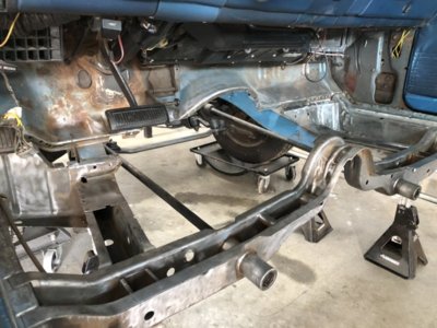

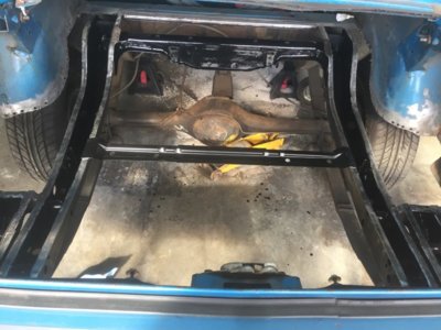

Thanks for all the kind words guys. I got out in the garage for a bit today before it got too hot. Just finished separating the floor pan from the firewall seam and removed the rear floor pans. This stuff takes a lot of time. I didn’t get as much done as I wanted, but I had to wash the boat because I took it out last night to go have dinner. Life can be rough.
