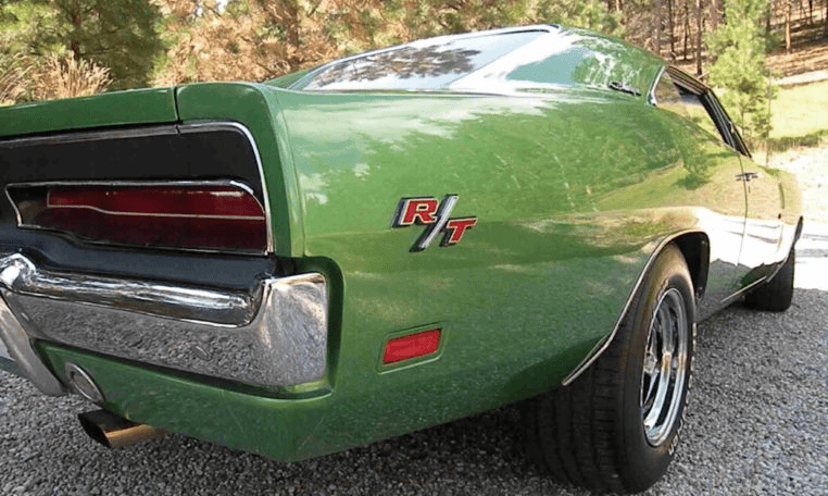

Hello,
I am looking for some help in decoding my fender tag with what my 1969 Charger R/T came with for a tail stripe. I understand V88 would have been the fender tag code for strip delete but I am not seeing one for a bumblebee stripe and the color. Does a Charger R/T automatically get a stripe with no need of a fender tag code? If that is the case how can I know what color?
91r/t
2:59 AM
May 7, 2011
2,798
3,958
Buffalo, NY
The stripe would be standard issue and V88 would delete it. If the stripe was deleted then there is no color listed on the fender tag to denote which color it was as their was no need. No stripe equals no color needed on the tag. Is this your tag in the pic? If so, it has V88 at the top right therefore no stripe color needed. If there was no stripe, it had the R/T emblems on the quarters which I kinda prefer as they look classy.

I looked over that V88 was on the fender tag:BangHead:. answered my own question. Thank You.
