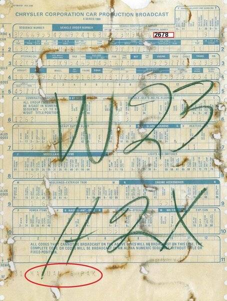

Would anyone know production numbers or if the A34 super track pak option was very common on a 1969 charger or any b bodies?
Check the dodge charger forum,theres a good thread there about numbers
Since you asked about any b-bodies.... super track pak was standard on A12 runners and bee's.
More than a few guys still over at DC.com should be able to supply some accurate numbers..... heck, the one guy even steered me to my Charger's original owner
A34 coded on the broadcast.
That might seem logical...but A34 is not coded on the A12 broadcast sheets.

I have a photo of my broadcast on my tablet.... but i ruined my tablet a few days ago, and couldnt access the photo. I just assumed, and i know what happens when you assume.....
