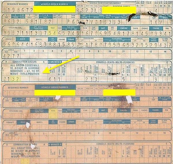

So, I am in process of having what I thought to be my original radiator restored at Glen Ray. As I am speaking with Bob S, he is asking me a few questions, such as stamping and date info etc. I tell him, what the car is, also a 4-speed dana car and the top number on the radiator is 2949 055. Bob informs me this is odd to his experience, if it is an A33 car. My trim tag does reflect A33, I then refer to my build sheet and the third line down reflects a 55 under RAD and up on line two it reflects a 56 for AXLE. In addition, and I am clearly no expert, down below on line four it reflects a 596 under AXLE.
My question, for those much more knowledgeable than myself with these cars/build sheets and codes, is this the correct radiator reflected from my build sheet? Is it an anomaly for a 1969 Charger RT with an axle package to have this radiator in it?

55 under rad is for the 055
The 26" 2949055 was available on 1969 B Body's with 383, 440, 426, MT/AT and with and w/o A/C
A33 cars have:
3.54 ratio Dana 60 sure grip,
Maximum cooling
7 blade torque drive cooling fan
and Hemi Suspension
A33 was only available w/426 04 440 with 4 speed
N/A w/AirCon
Thank you for responding, but I am still confused. My trim tag reflects A33, and my build sheet reflects 2949055, correct me if I am wrong, but this radiator is not considered max cooling, correct?
My car has the correct dana rearend, 3.54 gears with tag still on the case, 7 blade torque drive cooling fan and hemi suspension, but the 055 is perplexing to me.
The car was built from that broadcast sheet. So if that sheet says 55 than that is the radiator it got. No better proof than that.

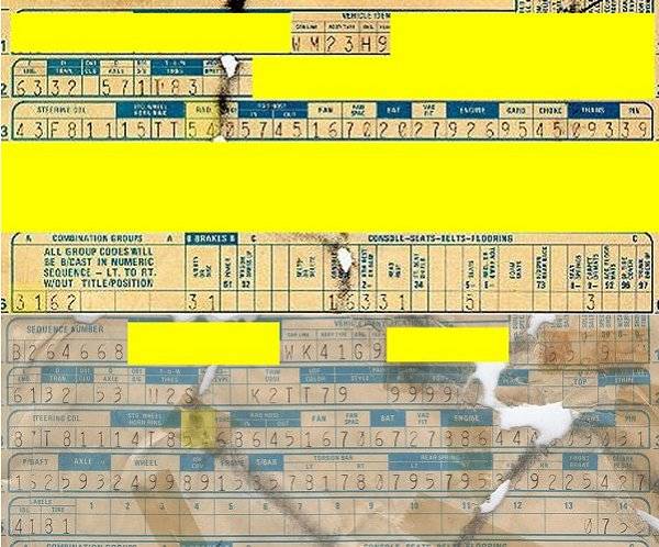

I'm surprised Bob would say that. I'm pretty sure he knows the 055 radiator is correct for A33.
MAX COOL package with 054 radiator came with packages like A31 (3:91 gears), A12/A32/A34 (4:10 gears), A35 trailer towing, and *K vinned 'cop cars'.
