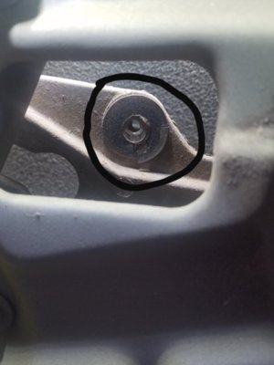

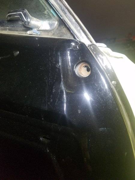

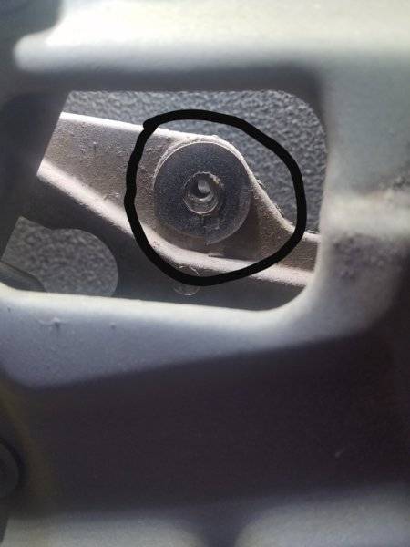

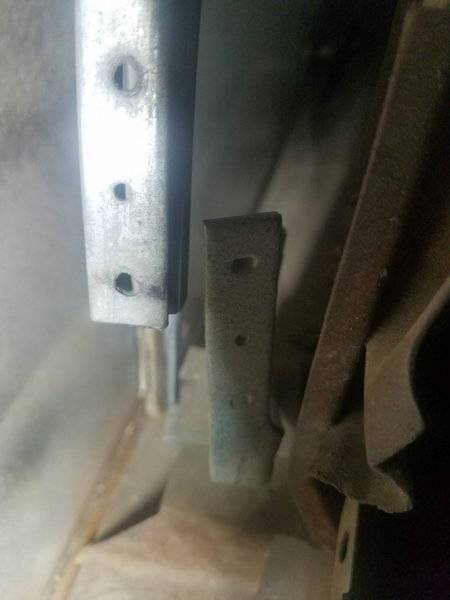

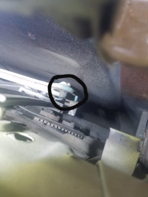

4. I'm starting to put the front door and rear quarter windows back in. The front vent glass was already sitting in the doors but looks to be missing some hardware. Please see the first and second pictures. The missing inside top, forward bolt for mounting the vent frame to the door looks to be a special bolt with a shoulder on it. Is that a special bolt? And is that inside lower bracket supposed to be riveted to the bottom of the frame channel?

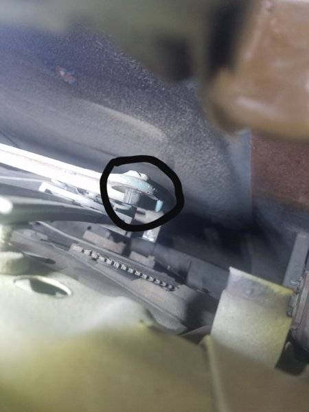

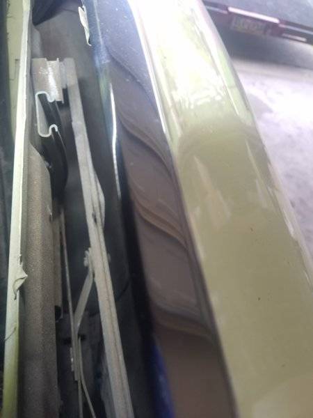

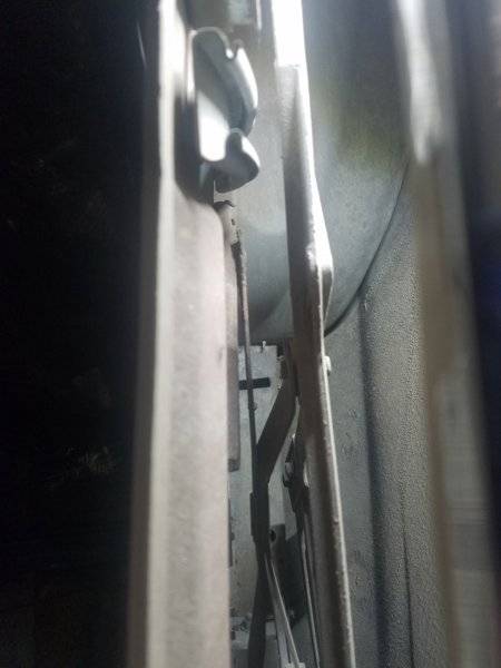

5. Rear quarter glass. Two questions there. First, there are no rollers at all in the rearward most regulator channel. (See pictures) This is the same on both the left and right sides but I am assuming that there should be something in there to properly guide the windows up and down? And finally, those two plastic bushings on the rear regulators that go through the lower holes in the glass that mount it to the regulator. The rear one looks broken, the bushings on the opposite side to mount the glass are threaded. I do not have the bolts. Are replacement mounting bolts and bushings available?

Going through this right now. Quarter window double roller. One side slides in track, other side attaches to window frame. RT specialties has them. Literally just did this install last week. Last picture is the mount for the bolt to go through window and sand which glass to quarter frame.
Vent window frame is broken. They fail at the spot welds. Unbolt. Run a tach on the side. Reattach.
First pic is a bolt hole to attach vent window to door after you re tack.
