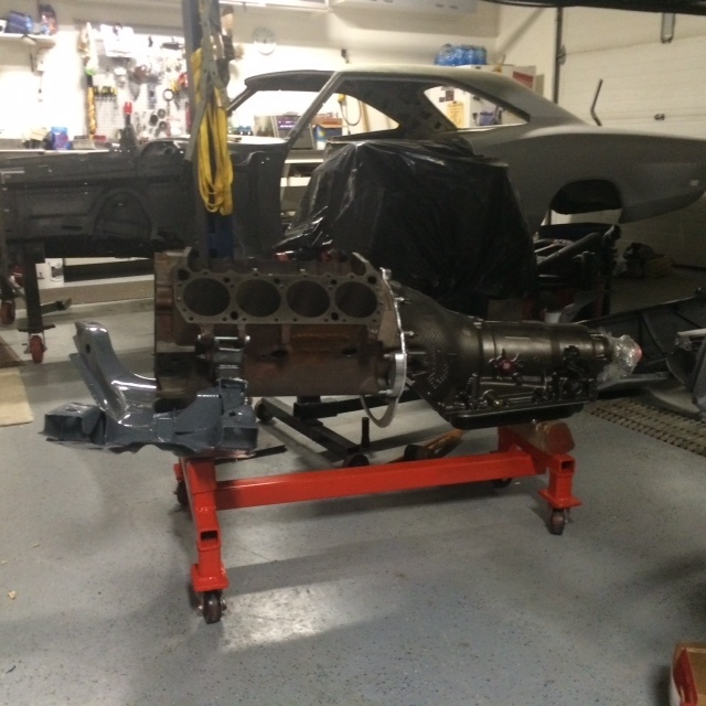

After a weekend of work, my son and I have the cart built, the aluminum adapter plate cut out and mounted to both Mopar engine and GM 4L80 tranny and the K member sitting in place. Ready to try a test fit pretty soon to get the initial cut-out for the tunnel marked. I am excited because I got so much done PLUS teaching my 18 year old how to weld and having him weld it up. According to the instructions from TCI, I still have to do some "reforming" of the starter side of the GM bell housing to make the Mopar starter nose go in with some clearance. That will be for another day.....Moper, thanks for tips on steps to refabricate the cross member and especially about the use of sleeves, great ideas.

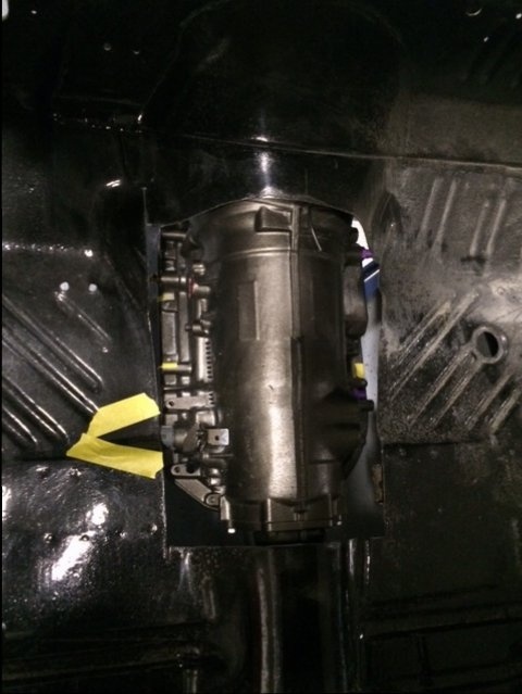

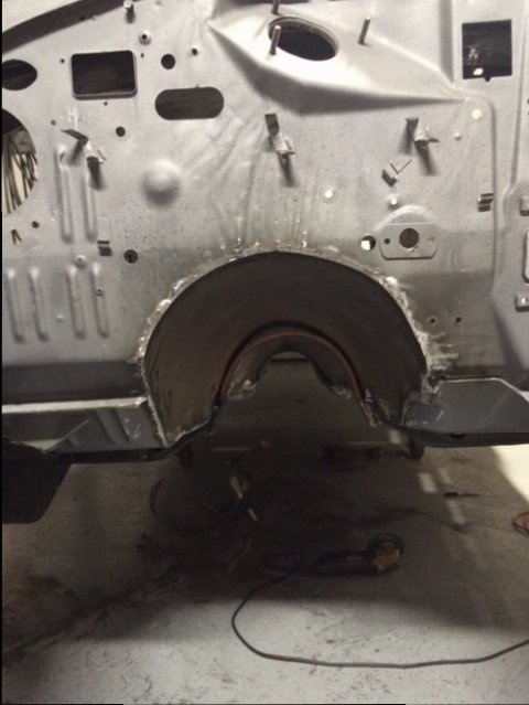

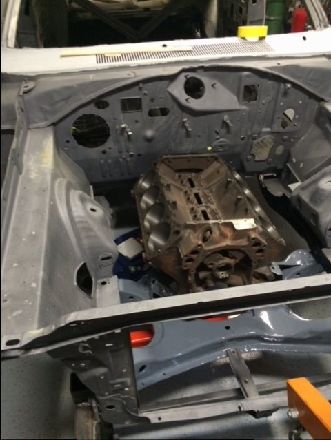

Making headway to anyone that cares... Made the initial cut and did a test fit..1st photo. Second shot is the finished tunnel and the extent I had to open it up to fit the 6 speed, 1 1/2" higher and 5" wider! The last shot is the look from the engine bay prior to final sanding and primer. I will make the tranny mount bracket after she comes back from paint. BTW, the extra little off-shoot hump in the driver floorboard coming off the tunnel is for the huge electric plug that goes in the tranny right at floor level.

You didnt forget to add room for any fittings or stuff attaching to the case, right? You need to be able to work on it too!
Good point Moper, the hydraulic lines and shift mechanism were two aspects I had to consider. The shift cable bracket attaches to the pan bolts below floorboard level by about 1 1/2" and the hydraulic lines have plenty of room now. I actually offset the hump slightly and gave it extra room for those lines with the 5" extra width. I will build the support and fab up that when she comes back from paint. Thinking down the line, I am wondering about headers and being able to get something to fit. I will give TTI and probably Doug's a call to see if they have ever done a layout for a set up like this. That extra width on this 4L80E is probably going to put the kibash on headers! May end up going to shorties or HP manifolds to funnel the gasses back which will not look as good or give me max performance I am after. I knew and accepted that I would be limiting myself in how much room I had but wanted the over drive aspect for long runs. Thank you all for the comments and tips, I will include one more set of photos in paint of finished product before I close this thread out. Mocajava

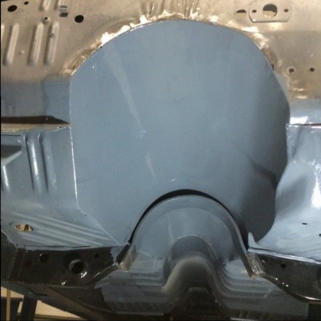

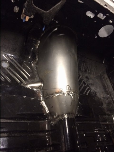

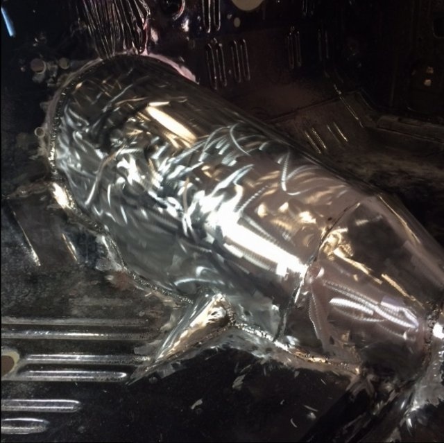

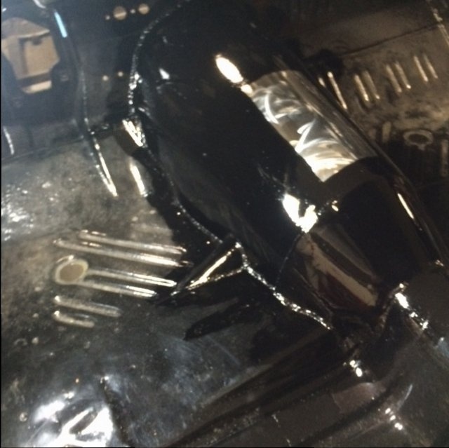

Well fellow FBBO members, I am closing this thread out. Here is the final shots of the new tunnel with POR15 top and bottom(I love that stuff!) First shot is ground and sanded from drivers side, second is with POR15 and a spot left bare if I need to weld tabs for shifter mount and the third is the underside with grey POR15. I used a piece of 9 5/8" casing, P110 material which is 110,000 tensile yield material to support the cross member for support and formed it with torch and hammer. I thank everyone who commented for the offered help, your support in very much appreciated.
