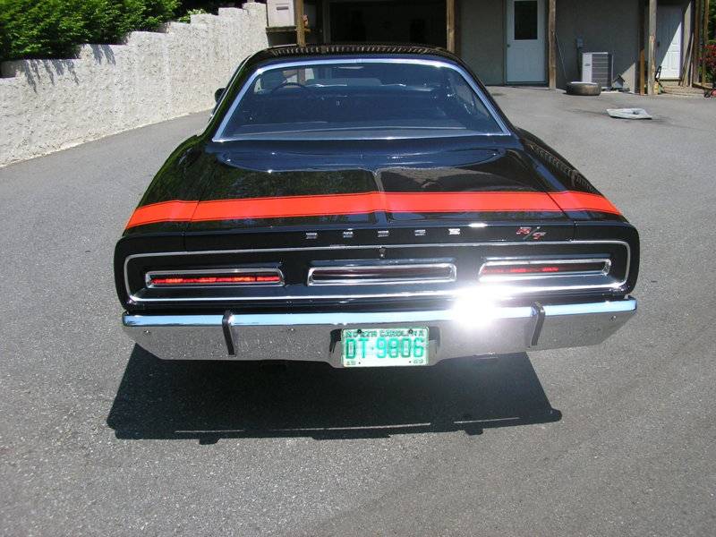

View attachment 275081Lynch Road build date of 5/20/1969. I have not seen a tail panel on a 500 or R/T from 69 that differ from this.

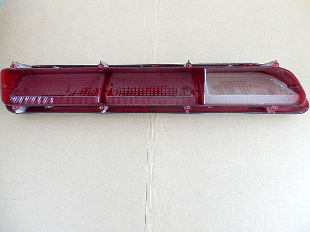

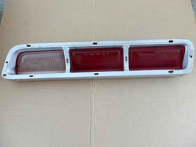

Not sure where the variation comes in,there is supposed to be a two and three bulb housing,the three bulb taking the raised lens.I have a pair of the more flat style but as I see it the housing will take either style. P2140299-001.JPGP2140298.jpg
Yes, there is a mid year change in the WH, WM, WP and WS rear lenses as described above.
The parts books shows a change "Before" and "After" 1/1/69 date for the change.
WH/WM referenced in section 8-55-7 of the '69 parts book and the WP/WS in section 8-55-194.

so let me get this straight if possible. I have a set of flat lens stamped 69 WH are these correct for a 69 super bee
Yes IF the Bee is an 'early' built car.
No if the Bee is a 'late' car.
Early and late being roughly defined as 1/1/69. As there is some overlap in part use, the further away from that date, the more correct or incorrect the tail lights could be. For example, if your car was built 1/2/69, toss a coin and use what you want. If it was built after 2/1/69, use the raised.
