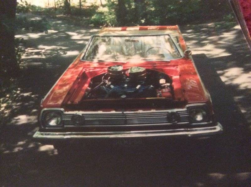

Don;t think there is any practical way to get a Xram under the hood. Think the MP manifold is an inch taller than 64/65 Xram. Had to cut my hood. 66 Satellite.
