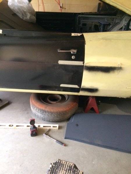

Oh: I have a great story on that. My son bought a pair for his 68, the one side fit pretty good. The other one suffered from AMD quality control and they cut the inner shell about an inch too far forward. So if you hacked everything to make the skin fit the opening the door shell wouldn't fit in the opening anyway. I took lots of photos and forwarded them to the guy that sold them to my son. He wouldn't do anything for us even though it was a $15k CDN order.
I ended up deskinning the old shell, fixing the rust and mounting the AMD skin on the old shell. Not impressed, this wasn't a "slight tweak".
The skins still needed tweaking front and back on the topside but that is to be expected. You will most likely have add some filler on the tops to match the fender and quarter.

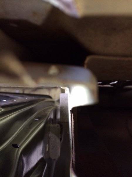

(The photo shows how far away the latch was from the striker with the AMD door mounted somewhat centered in the opening, beautiful)
