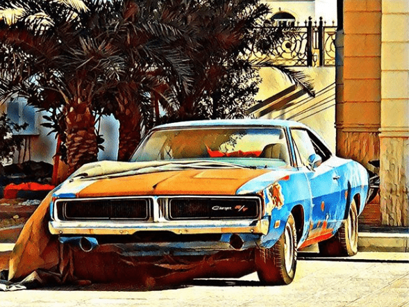

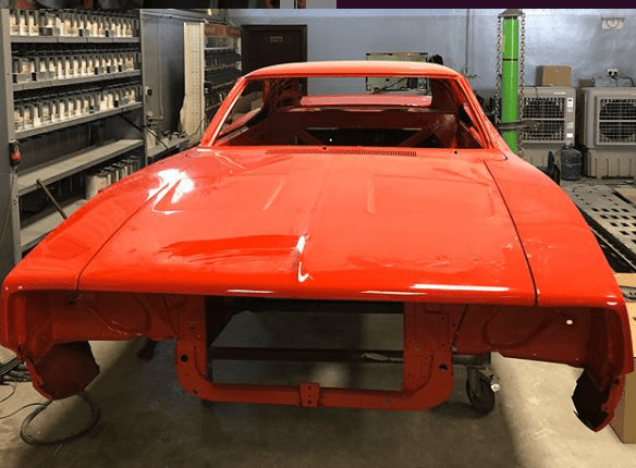

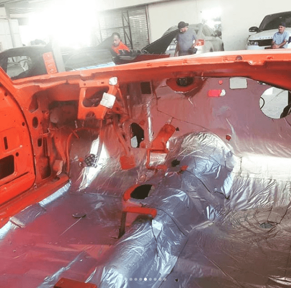

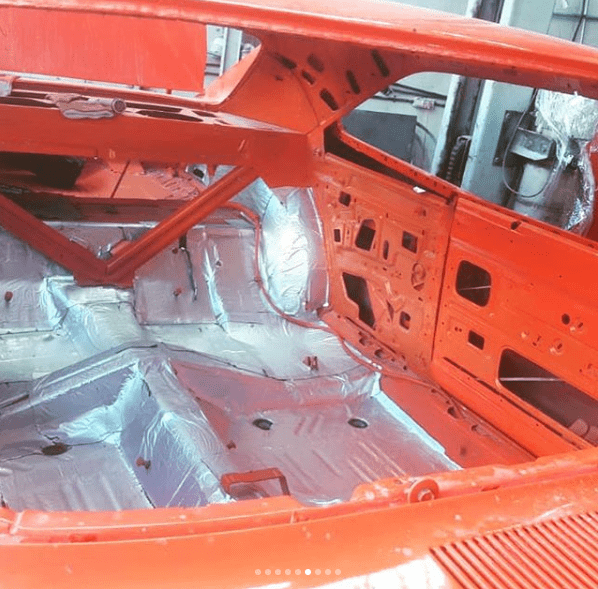

Hey all,
I decided to post about my 69 Charger on this forum, i usually post it on (Instagram: 1969Dubai).
Would appreciate to get tips and information about parts later on.
Car: Dodge Charger 1969 R/T
Engine: 440 Mopar Big Block 7.2L with holley
Transmission: Stock (Manual )
Things i need to buy:
Brake Kit Front & Rear: Still looking
Suspension kit: Still looking
Fuel Pump: Still looking
Fuel Tank:
Still looking
Engine Upgrade: Thinking about it
Transmission Upgrade: Thinking about it
Digital cluster ( Speedometer ) replacing with the old one.
Note: Hopefully this will be a daily used car.

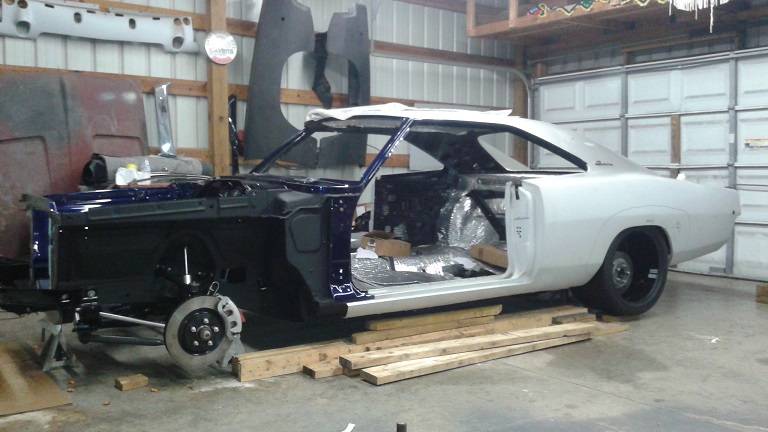

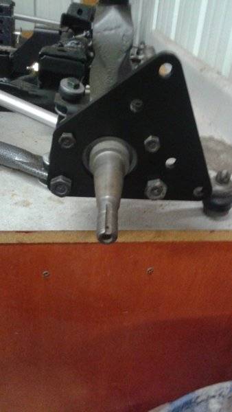

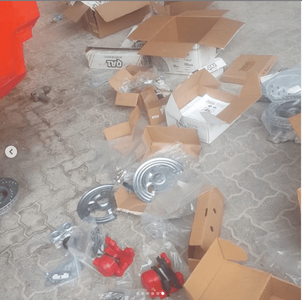

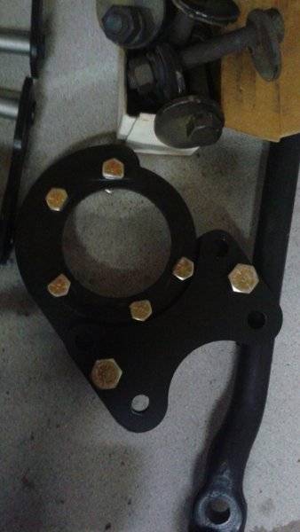

Check out a user named "invincibleextremes" on dodgecharger.com. He makes caliper brackets for different setups. Not sure on the pricing, but they are very affordable. I used 2014 Mustang GT calipers and 13" rotors on the front and 2014 Mustang GT calipers and 12" discs on the rear. I bought OEM takeoffs from ebay for around $150 per set. I was able to easily piece together a 4 wheel disc setup with hydroboost for around $700-$800.
View attachment 726838 View attachment 726839 View attachment 726840
Wow this actually looks great. 700-800$ pretty good to be honest. My budget for the brake kit is about 2000$ max
Thanks for sharing i will differently check them.
Good start there! I did the same as above, went with caliper brackets and Mustang Brembo brakes.

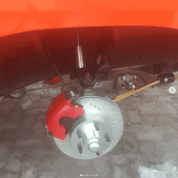

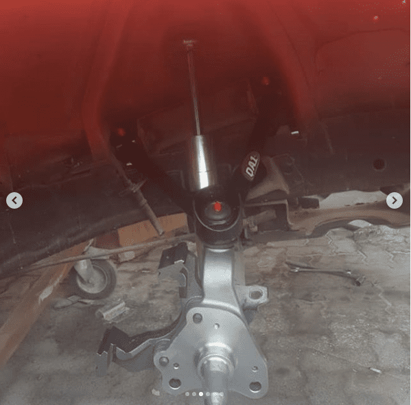

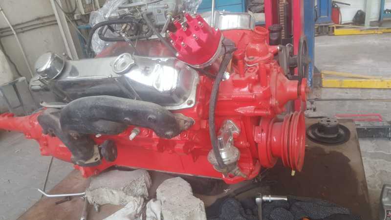

Quick update:
Installed the brake kit front/rear + the QA1 suspension for both front/rear
I found out that i need to buy new ball joints :S

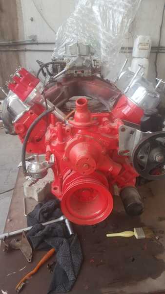

Engine/Transmission Done. needs testing now.
