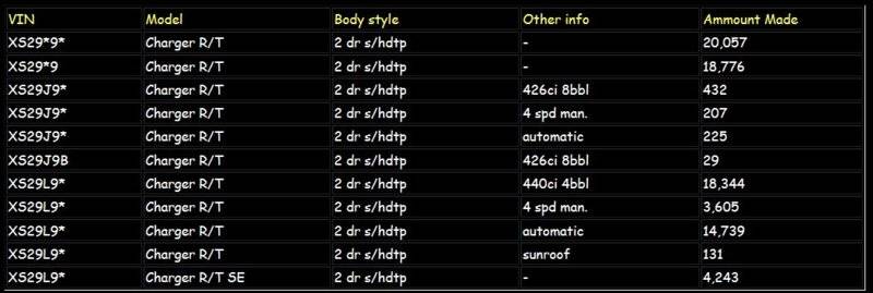

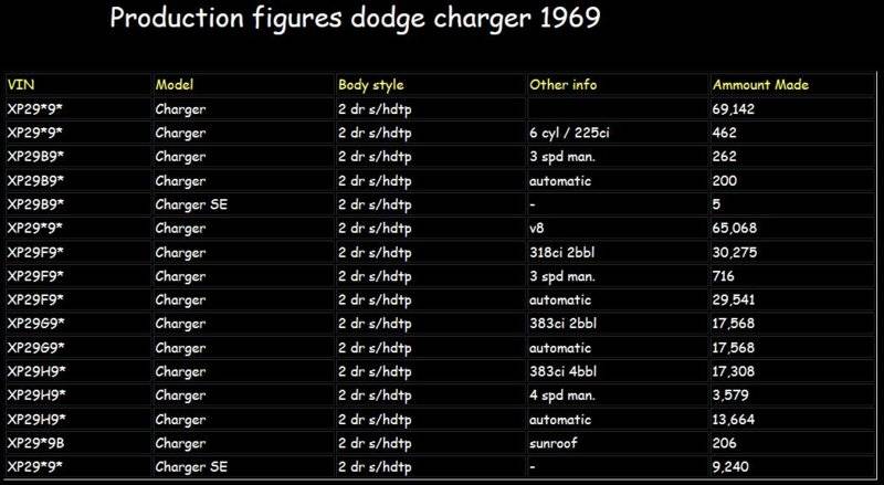

According to the numbers I have found, they made 5 Charger SE's with a slant six motor (fifth digit in vin = B). Pretty rare! They made 9240 SE models with other various motor combinations (see charts below). SE models weren't as rare or desirable as hemi cars, 440 6pack cars, or 500's and Daytonas, but they are unique in that there were much less of them than regular Chargers or R/T's.

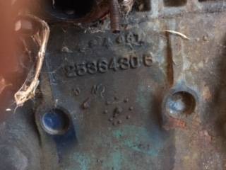

One thing to check also is if the 383 is an HP engine. This info is on a flat area by the distributor. And if it is the car you want then in my opinion, worth whatever you want/can pay. You only live once, go for it and fix it up right.

Thank you. I was able to get the seller to send me a pic of the number on the engine(see attached). Is it possible to determine the engine type/date from the pic? The numbers are 2536430-6 and it appears to have the date stamp?

I forgot to add on the last reply. The vin number on the car contains a G which I believe means the car came with a 383, but I don't know if it is a High output ? The last 6 numbers of the vin on the car are 277628 , so I don't think this engine is the one that came with the car? Any assistance would be great.

I got the numbers off the engine 2536430-6 date 4/67 I looked up those numbers and it appears to be a 440? Is that correct? He told me he thought it was a 383 but now I think he is wrong?
Am I seeing a 4-67 build date?[/QUOT
I decided to run the numbers and both sites I looked it appears to be a 440 are you able to confirm. If it is it is a great surprise! Thank you.
