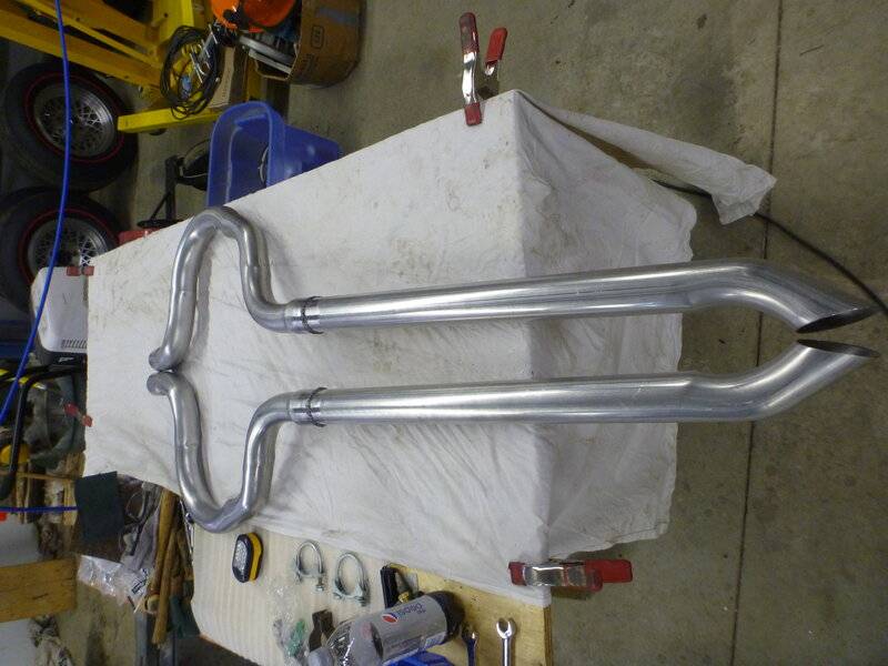

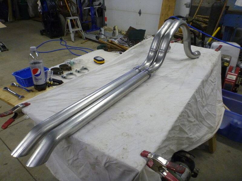

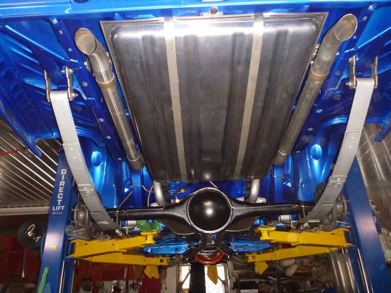

Can't help on the code, but can on the tail pipes! ECS are correct.
1969-1971 Noise Reduction Package - California cars with U,V and R engine codes that have N97 code. (includes a H pipe, mufflers and resonators)
