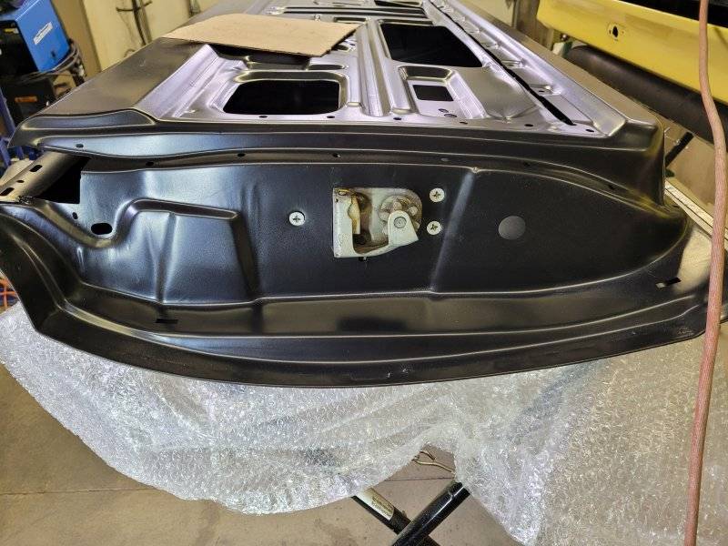

The rear channel/guide is adjustable. Bolt at the top (with some minor adjustablitiy) is in the rear "jam" face of the door near the top, but this is mainly the "pivot point". The lower nut is accessable (at least on a '69) through the plastic plug down lower. You just need ot loosen the nut and it's stud slides back in forth in a long slot. On a '66/67 you have to pull the door card to adjust it, I'm unfortunately into that next on my '66 as the glass is tipped to far in at the top.
