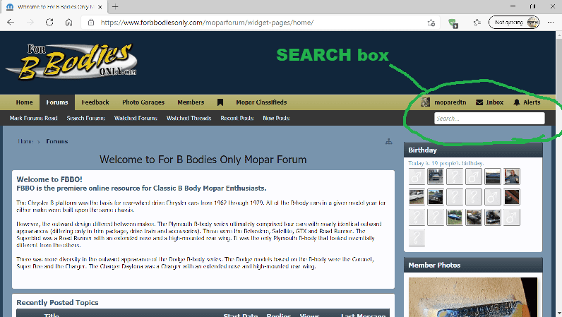

There is a metric crap-ton of videos, articles, posts all over the internet on converting
an auto car to stick. Do your due diligence (homework) and use the "SEARCH" box
liberally.
There's literally threads going on here at FBBO right now of people doing this conversion!
