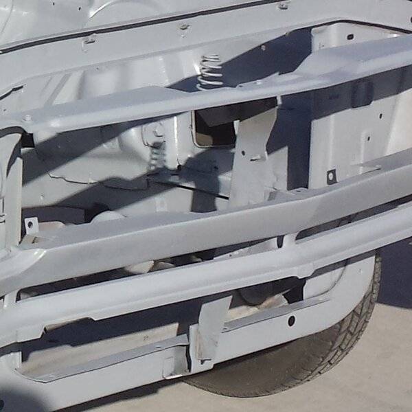

Sorry, this isn’t the best pic but, does this have the latch pictured like you’re wanting?
Need image of vertical support behind grill that supports lock and goes down to lower radiator cross member Thanks
Yeah, I kinda figured you would need an interior grill shot. I can grab a pic this upcoming Saturday but, hopefully someone else will be able to circle back to this thread sooner than that.

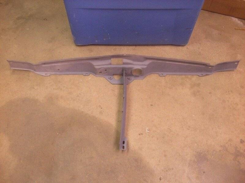

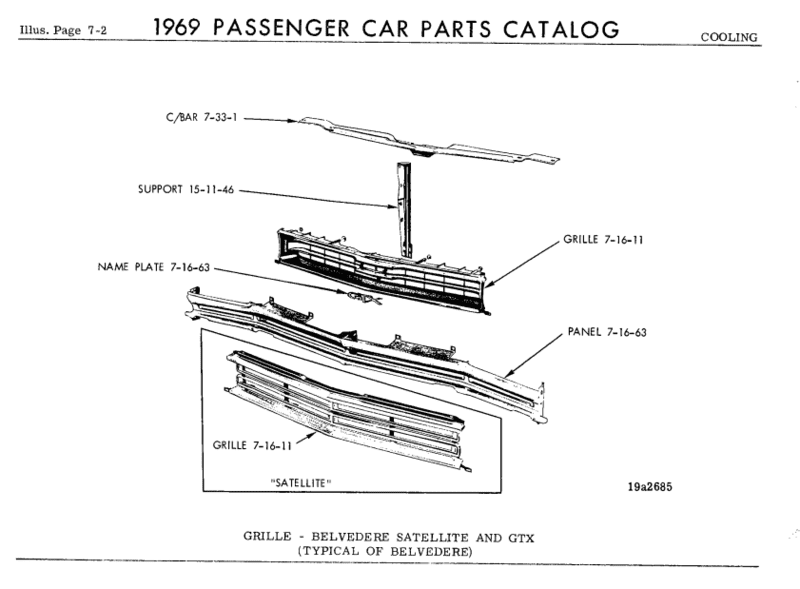

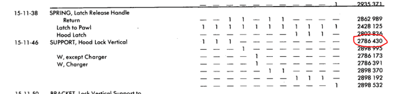

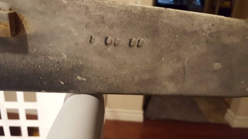

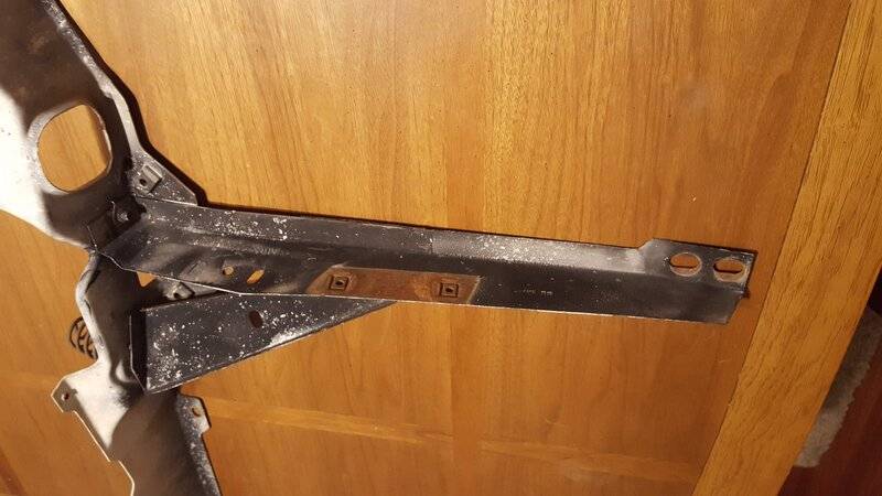

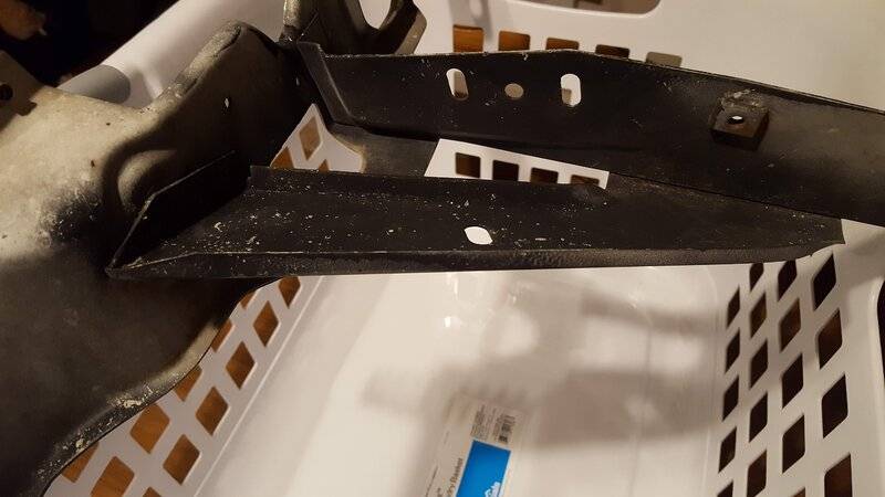

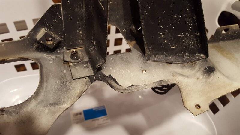

See attached. This is for a 68. 69 top horizontal piece is different, I don't know if the vertical piece is different or not. The pieces are not made to come apart.
Thanks for the info didn’t realize there were 2 pieces

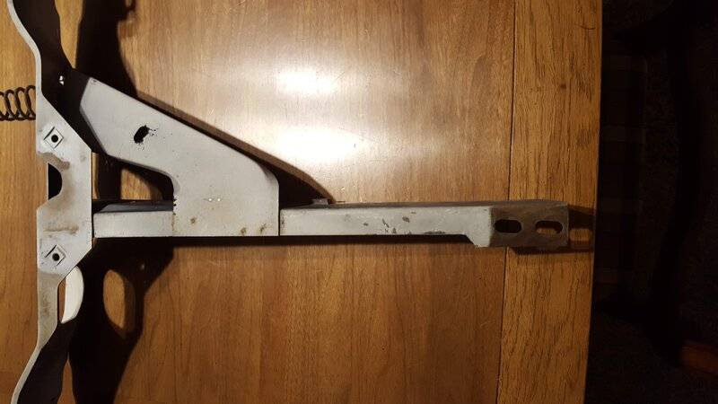

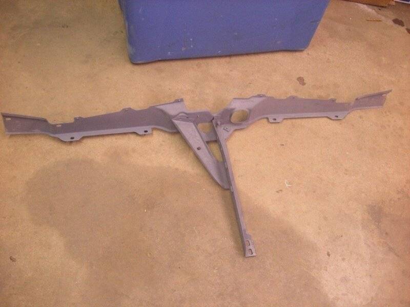

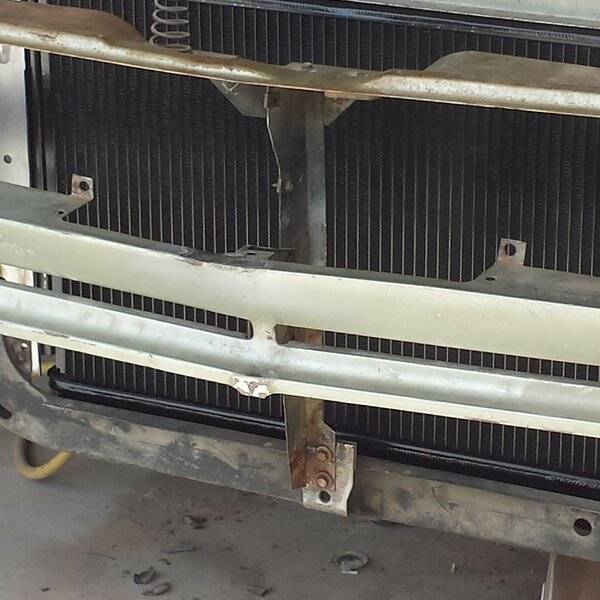

Here's a few of my 69 brace... not very detailed but what I have.
