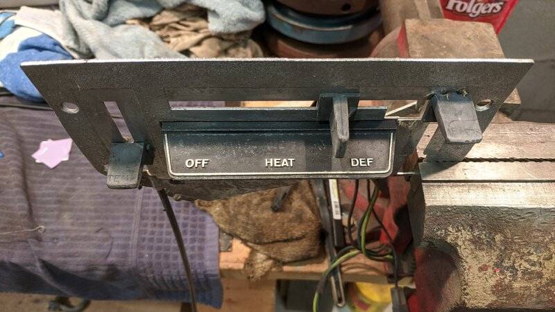

Mopar experts, looking for advice how to restore the control knobs on my non-A/C
69 GTX. All suggestions / recommendations appreciated
Here's what I did with my controls (A/C so even more knobs):
Scuffed and painted the knobs black. Used rub-on dry transfer letters for the script. Sprayed matte clear coat on top to protect the script. Came out perfect and looks much better than the available decals.

Thanks for the feedback; can you tell me more about the rub-on letters?? Where do I buy??

I know you guys are going to laugh and think it looks hokey, but not knowing about the rub on letters, I used a label maker on the one side that was worn off. The font was exactly the same as well as the letter size. Probably not as nice as the rub on, but not bad and I have yet to have anyone spot it.
I painted flat black and tried to fill the letters with a fine tip paint pen but it does not look great. I am going to try the rub-on lettering next.

I used the stickers and sealed them with clear plastic paint to keep the letters from peeling or rubbing off.
