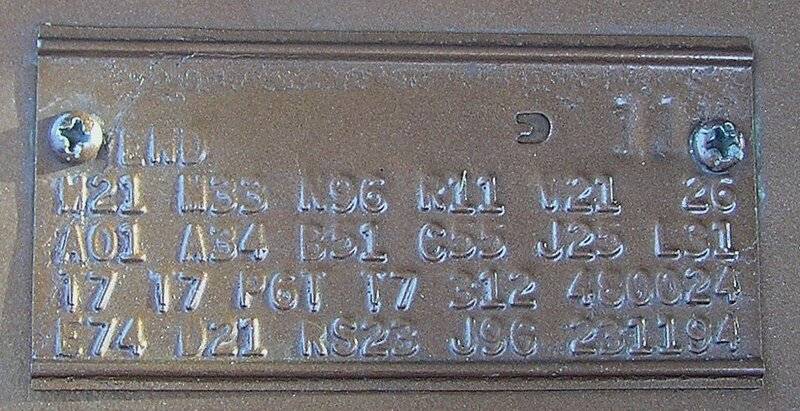

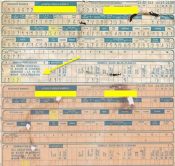

Look in the A box on the broadcast sheet for the A32 or A34 package code. Look for the same code on the fender tag.
View attachment 1145265 View attachment 1145267
Hey there F4R/T man. You provided the best info. Our broadcast sheet indicated 01 32 under the A “combination groups” field under section 6. The fender tag also has A32 on it. Which I gather also means super performance axle package with 4:10 gears as well. Depicting a super trac pack 440 plus auto. Which is what we have. Fender tag Also has A31just before the vehicle order number At the top but I don’t think that means anything. Jeez I hope I have this all correct?
