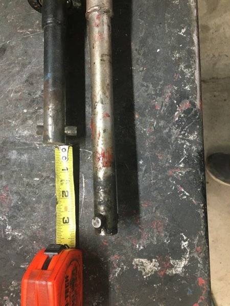

Does any one have dimensions (length) for the column shaft for manual steering?
Also what is the length of power steering for others reference in the future?
Thanks to all who can share such details. Anyone who has a collapsed shaft this will be good reference.
From the coupling pin to the top of the thread appears to be 44 inch’s on
Just did a manual to PS conversion. Manual shaft is 43 3/4 to the pin center and 44 1/4 to the end of the shaft. Took a pic of the ends by the pin to show the difference. 68 R/R column shift no tilt if they even made one ??
