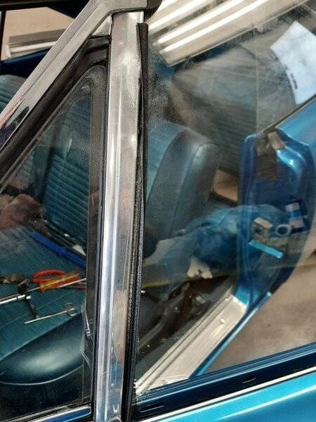

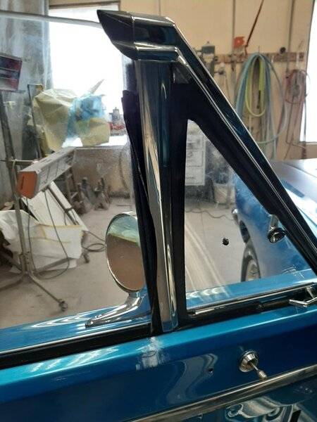

Where can I find these guides? Year One send some they were below standard of the normal any other suggestions?

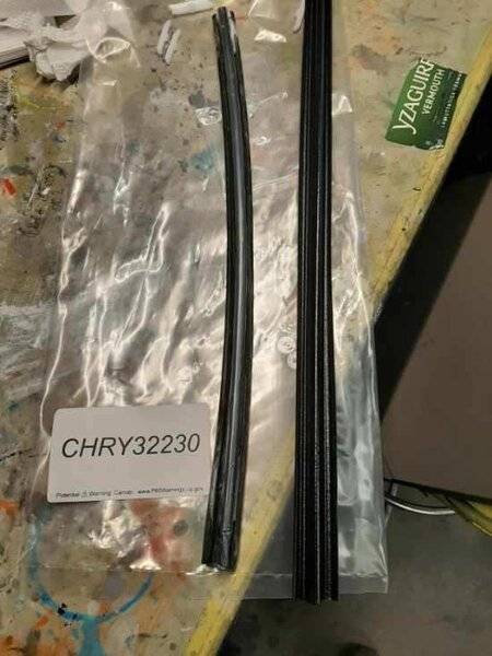

Good luck. The real ones have been discontinued. Only those crappy aftermarket ones exist now unless you pony up some big bucks for some real Chrysler ones.
If you are using reproduction glass, it is a bit thicker and makes using the reproduction slides that much more difficult to use. The reproduction slides can be used, but it is best to modify them slightly to remove a portion of the "wings" on each side of the primary channel. Also, reuse the original "H-Pins" or sand the sharp corners down on the reproduction "H-Pins". There are numerous post on the installation of these pieces on this and other forums.
If your very lucky and keep your eyes open, you can sometimes stumble across one of the factory Chrysler channels. Most people who have the originals will be getting stupid money for them. With that said, I have both available.
Interested in your offer not sure how to conduct business on the site? Email? Phone? PM?
Check out Steele Rubber, they probably have them and likely better quality than Year One, if not they may be interested in making them if you have a good sample for them to use.
