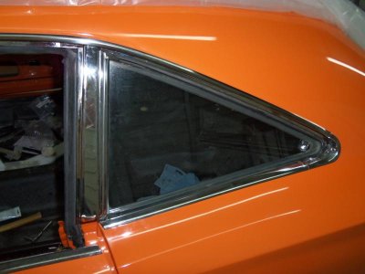

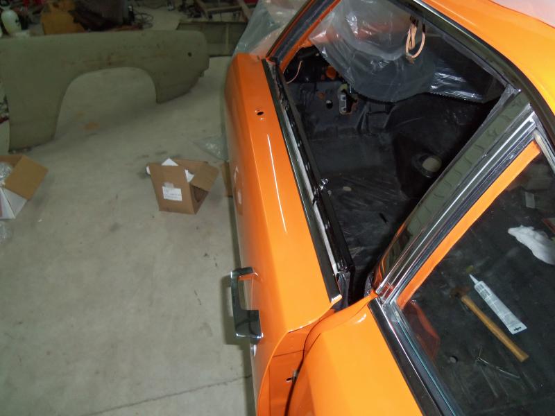

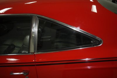

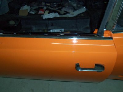

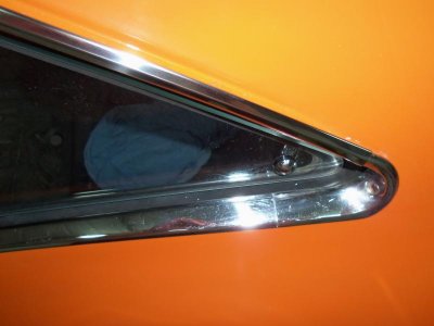

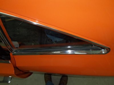

Flypaper is correct. I think M-31 is the trim code. My Superbee has them. It runs under the pop out glass and continues down the door under the door glass. Don't see many cars with it , but it sure looks good to me. I'll try to post a picture.
Thanks. I can't find that I took anything off when I disassembled so it probably wasn't there. If you have a picture, that would be great.
Appreciat the responses....
M31 is the correct code for the belt molding. It is not common to find this on Roadrunners or Super Bees but they are out there. I agree it does look nice.
Picture below shows the M21 code, drip rail molding and M07, center pillar molding as well. All were on the build sheet for this car.
Hope this helps. D
