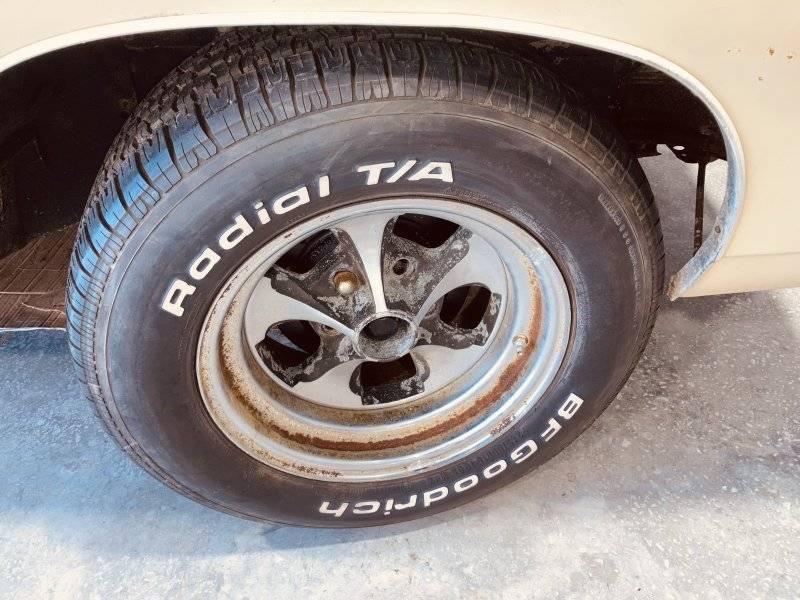

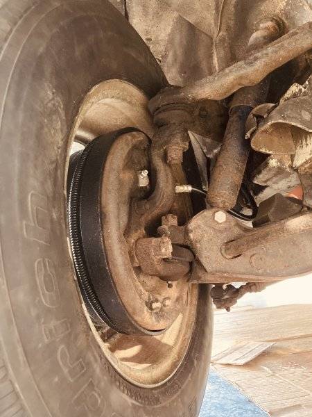

I have my old 15x8 Keystone Klassics with 3.5” of backspacing with 245/60-15 Radial T/A tires mounted for mock-up. The tire BARELY clears the front fender lip on turning the steering wheel. Additionally, the inside wheel bead BARELY clears the UCA. So I don’t think I could go to a 255/60-15 tire on a 15x8 wheel with 4.5” of backspacing. I think a 4.5” backspaced 15x8 would never fit on my car with the stock brake drums. But, it seems like everyone sells 15x8, 3.5” BS wheel for our Mopars. Unless, they are meant for disc brake converted cars with a slight wider track width.
