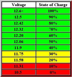

Your surface charge should be at 12VDC +- .5 volt.

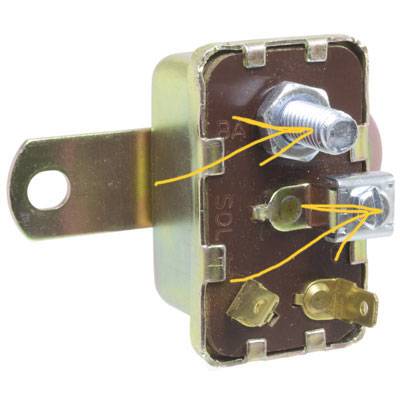

You can always jump the starter relay and see if she kicks over.
With 11 volts something should move.My money is on the relay. Check the power on the other terminal of the starter relay to make sure its closing the switch. One post will have 24 hour power and the other will only have power when the ignition switch closes(key turn). If you are getting battery voltage at relay post then check at starter. Or spend 20 bucks on a new relay and odds are it will fix the issue. Then test drive the car back to the parts store and buy another one and keep it in the glove box.
How do you do that? I can't get another car close enough to jump because its in the garage. If the battery is to low shouldn't I at least get a click?
Actually I have another relay, I'll go try it now.
Just stick a screw driver between the two contacts on the firewall mounted starter relay...it should roll over.

Stick something metal between the arrows.
It looks like it was relay, I put a new one in and got clicks. Not sure if it was grinding or clicks but I got something. I hope it wasn't grinding. I think I may have a bad battery too, the voltage went down to 8 volts so I am charging it.
If your voltage went to 8v while cranking (or attempting to) you have a dead cell.
11v (static) is about equal to a dead battery.
Well, I charged the battery a little and got it to turn over. The starter was wining and then clicked. I think I got a bad battery, what's you guys thought's? Should a brand new starter wine?
