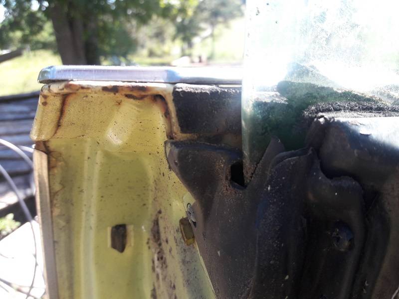

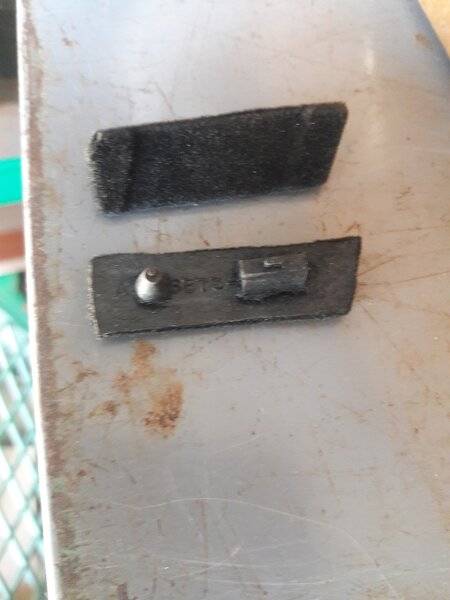

The Door Window Fuzzies Seem To Be About 2 Inches Short. Is There Another Gasket That Goes Toward The Back Of The Door. Thanks

Hmmm, I don't remember removing those. Are they peculiar to either a coupe or sedan ??
All of the 68 to 70 B-Bodies used them with the exception of the convertibles. Made by Metro.

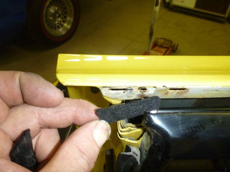

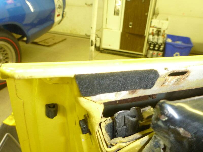

Wayne, the post cars used them as well. The picture that I posted is from my 68 Road Runner post car that is an original paint car. Both of my October of 67 post Road Runners had the door end plugs. For whatever reason, the only cars that I have seen to not use the door end plugs have been the convertibles. I would not swear to the fact that some of them may have used them as well. Never looked close enough at original convertibles to document that fact.
