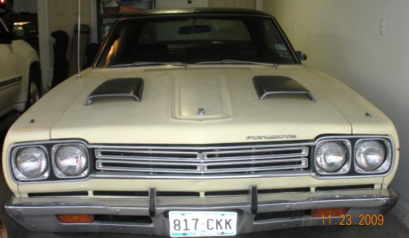

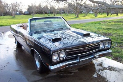

When I got my 69 satellite this hood was on it, but every picture I have found a satellite did not come with the hood scoops the mine has on them. I believe this hood came off another car? Was wondering if anybody can tell if this hood is original and should it be on my car? Also, is this hood worth anything?

You are correct........Not original. Those are dodge scoops. The rest of your hood is correct. Satellite hoods are not that hard to come by. You could probably sell those scoops and buy a couple of them.
Yep, that's the original hood just like on my satellite, but someone added the scoops.
You are correct Propwash - I have 2 original satellite hoods and have tried to sell them on craigslist several times and nobody wants them! They came with my car when I bought it and are just leaning against the fence minding their own business and not doing anything. Got a re-pop RR hood with the side inserts from AMD, but I'm wondering if I should keep one of these hoods. I kind of like them with the flat hood "sleeper" look.
Imagine the Satellite hood with RR scoops grafted on, slightly raised and enlarged say up no more than 1 inch, massage it into the hood, I say this would look uber cool! Yup, I got a good Satellite hood to use, and the rusty skin off a RR hood -- one of these days I'll get to it!
Just in case you wanted to know the scoops are 70-72 a body doge scoops they are worth a bit of cash if you wanted to ditch them. :)

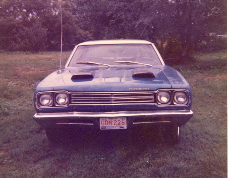

I have owned this '69 Runner since I was 15. The original hood was left upside down for years before I bought the car and was rusted through the front edge, so I put these '69 Super Bee scoops on a Satellite hood.
I think they look good, so if you like them, leave them on. If you don't, you could also put a '69 Six pack scoop on your hood.
I'm not sure of the source of the Satellite picture, but evidently this is not as uncommon as you would think. The '69 Super Bee/Coronet R/T are about as closely related to your car as you can get, so they definetely fit the look of your car.

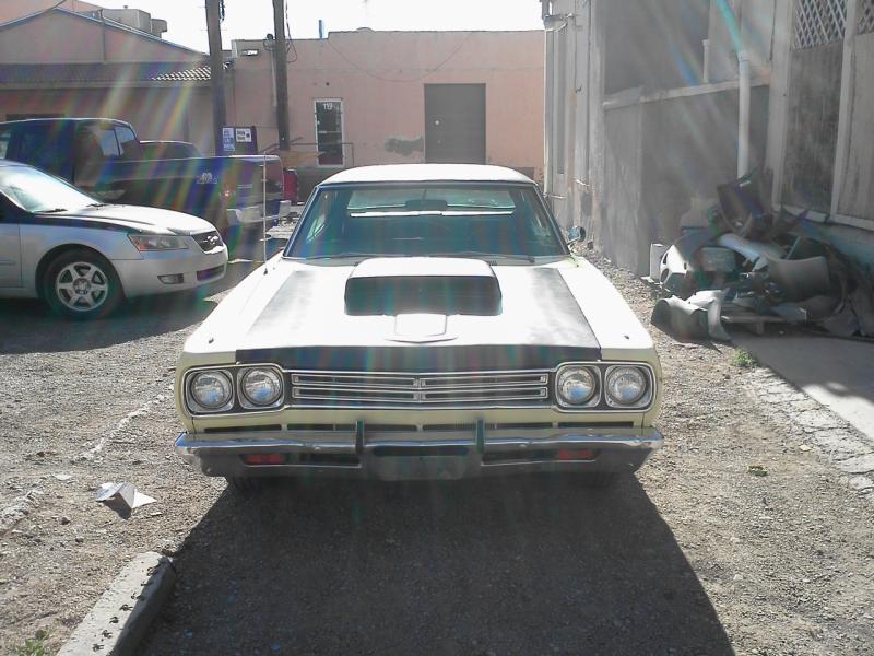

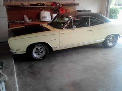

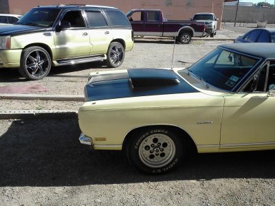

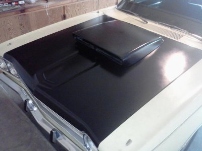

Hood Complete
Like promised here are a couple of pics of the original hood with the Six Pack scoop on it. Added a 1" wood spacer underneath the carb and moved fuel lines, no issues anymore!! Thank you all for your help!!!:headbang:
