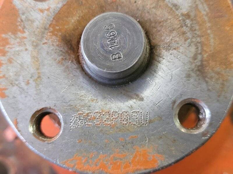

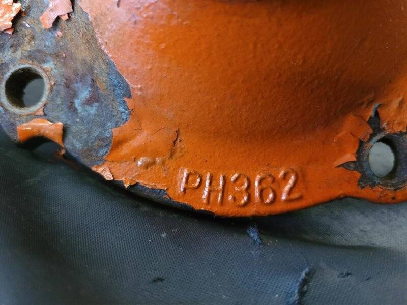

The water pump is part PH 362. Also has other stampings. Would this be original for a 1969 Super Bee?
A4133C0D-6270-49D5-A104-BD6C60877C9B.jpeg B0E49881-0345-4661-A3A4-9E3C19C288F3.jpeg
I will have to ask the shop tomorrow for the blade count and diameter. Anyone have a rebuilt one available?
Usually, when a pump is rebuilt, only the casing and maybe the blades are reused if there is no significant corrosion is present. The shaft and bearing assembly is replaced along with a simple cartridge mechanical seal assembly (carbon vs ceramic) and the impeller is pressed back on. Any major auto parts store should be able to furnish what you need. Flowkooler is a great replacement component as it increases the coolant flow both in terms of velocity and gallons per minute flow. Something to consider.....just my opinion of course.
