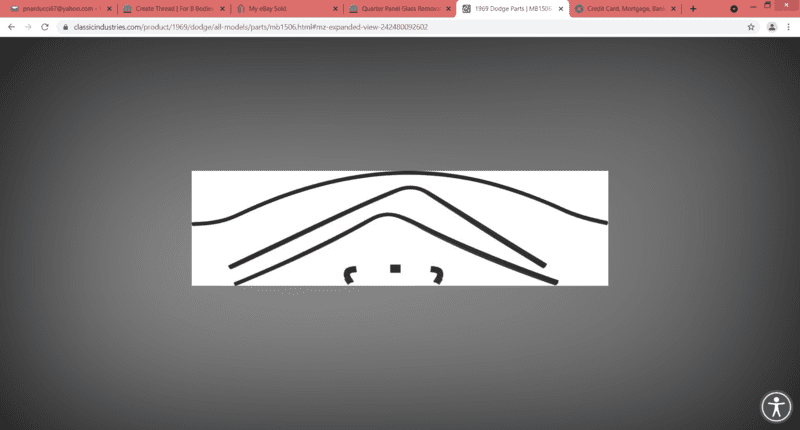

Would you mind sharing the ordering information from CI? I can’t find anything on their site that’s sold by the foot under description of “rear window windlace”. Thanks in advance
This is the P/N for the off white by the foot WL212. I ordered 20’ which will cover everything on car and rear window.
Thanks for the info! I found it, I need it in black P/N WL300 for anyone else looking. Classic indicates it is in stock. Did you receive and install yours yet? If so, did it work out ok? Just wondering. I have the other style 4 piece kit on backorder that is questionable according to posts here. Wondering if I should cancel and order this style instead. Thanks again for posting.
**CORRECTION-The correct P/N FOR BLACK IS WL200. SORRY. Fat finger stabbed wrong key.
Yes, much better than that POS kit that they sell! Sorry that I don’t have pictures, car is a ways away

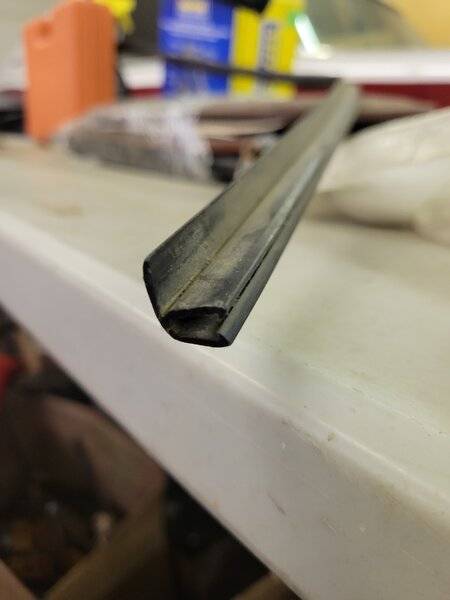

I am going to try using one from year one and it is for a 68-72 GM A body, it has the F profile and a while back somone on this forum suggested it. My car has the one piece also so it too must be a late 69 that was also built in LA I have yet to put it in but received it and it looks very close to original. Hope this helps
dcmason69
Here is an original 68 if that helps
