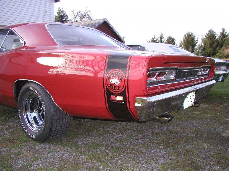

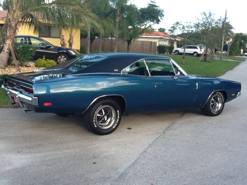

Here is a couple photos of the wheel/tires on my cars.
