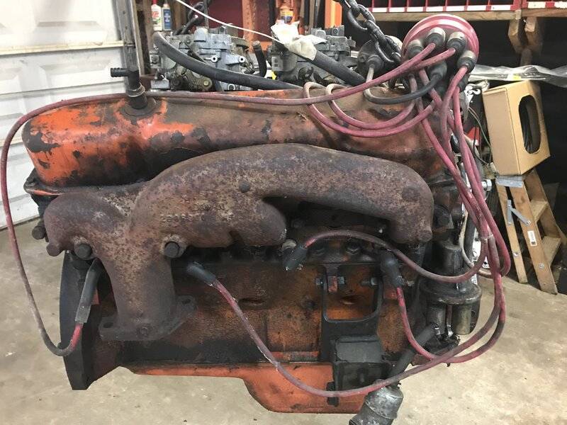

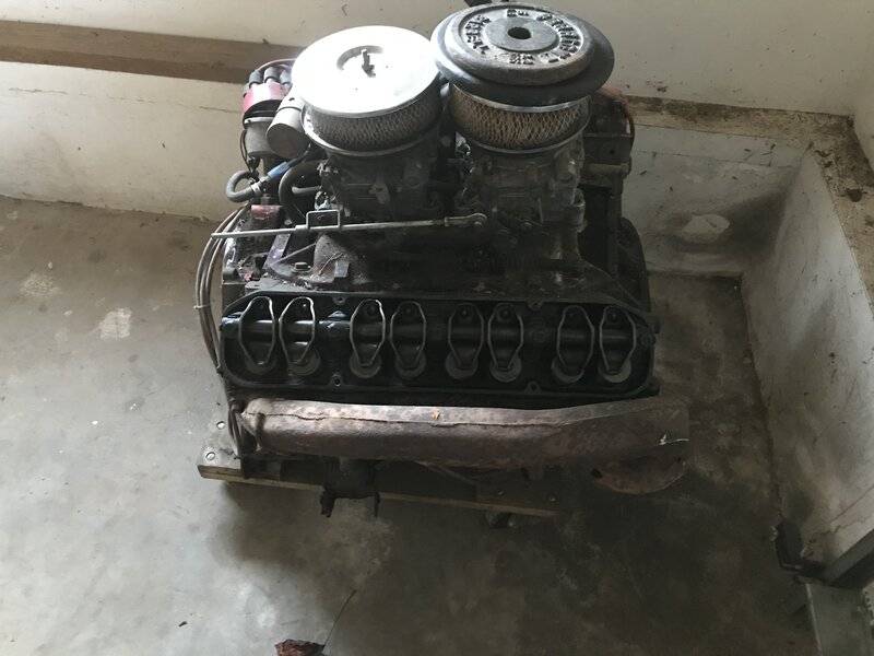

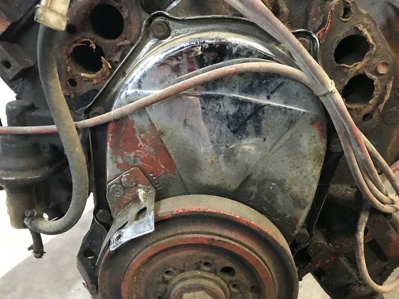

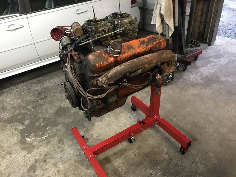

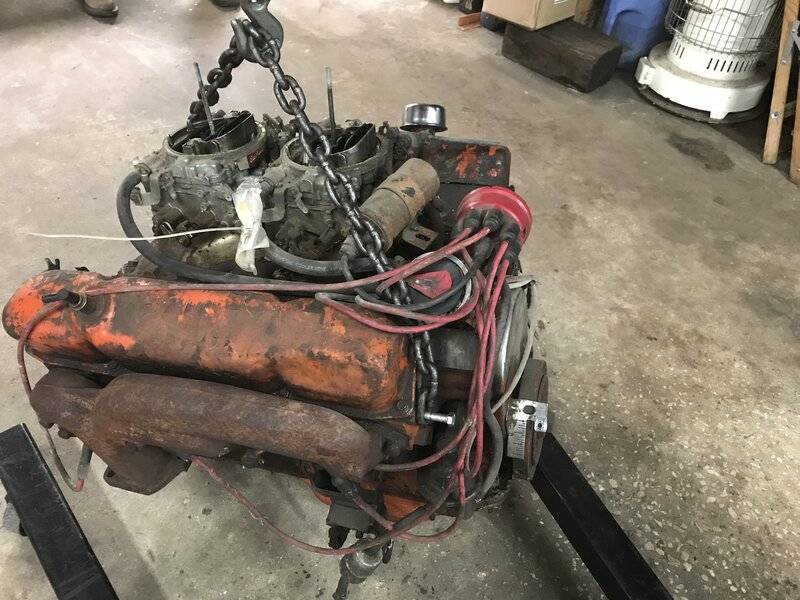

I found a 383 Engine in the garage of a house that I am drawing a renovation plan for and they were going to send it to the scrap yard but said I could have it so I got it and I believe it may be a magnum motor but know it is HP at least. It has the windage tray and high volume oil pump.

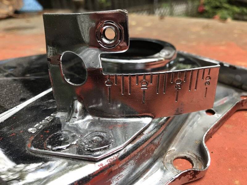

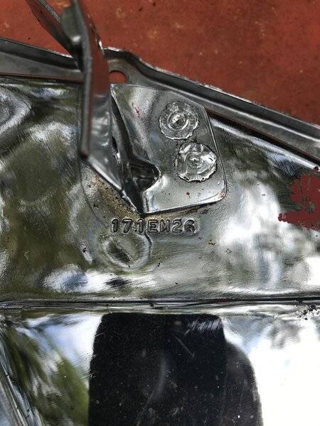

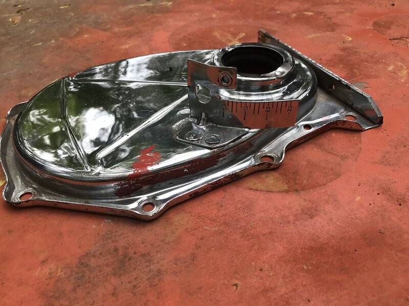

The question I have is about the timing cover. There is a little nut welded on a tab in front of the timing advance marks and my machinist said he did not know what it was for. Has anyone seen a cover like this and the purpose of the welded on nut ?
I added a few pics of the motor as I found it.

Being chrome it is some sort of aftermarket cover. The tab must of been designed for a crank sensor of some type. Has a similarity of a lean burn cover but not quite the same.
That timing cover is from a late 70’s engine. Didn’t come in a 1970. Neither did the hi-volume oil pump, Mallory distributor, dual fours, someone was building a hot rod! It has 1969 or older valve covers.
dual quads? DUAL QUADS???? And a prestolite dist to boot?? You dun good!
The nut thing is garbage from the smog era.. Mainly for industrial apps I believe.
Nice score!
Are you going to run the dual quad carb setup on your new build?
SCORE! Wow dude. That timing cover looks like the old Direct Connection chrome valve cover. I have one and never did figure out what that nut is for. Crank trigger as someone else mentioned sounds like a good possibility.

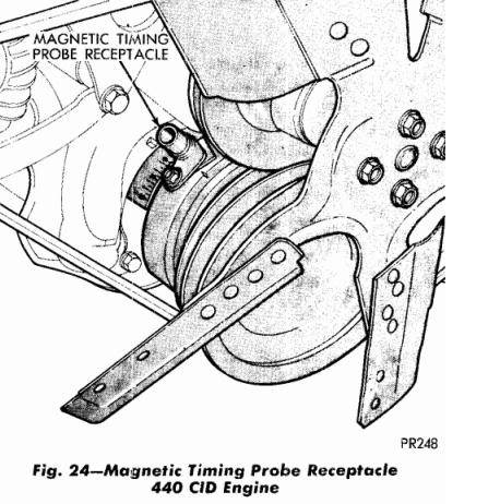

The more I think of it there was an adapter for the Mopar magnetic timing probe that fit into the tabs hole and had an ear that bolted to that nut insert.

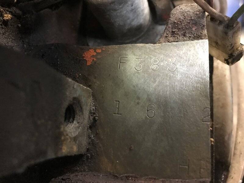

The block casting number is ( 2468130-7 )
The serial number is ( OG181344 )

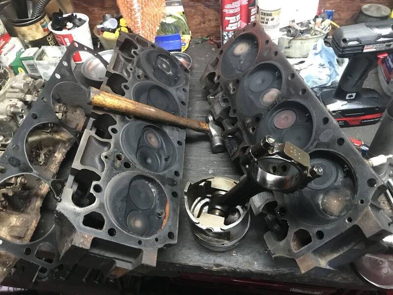

The 906 heads were gone and replaced with 516 heads :(

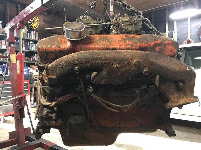

It has HP exhaust manifolds ( Drivers side 2951865 ) ( Passenger side 2806900 )

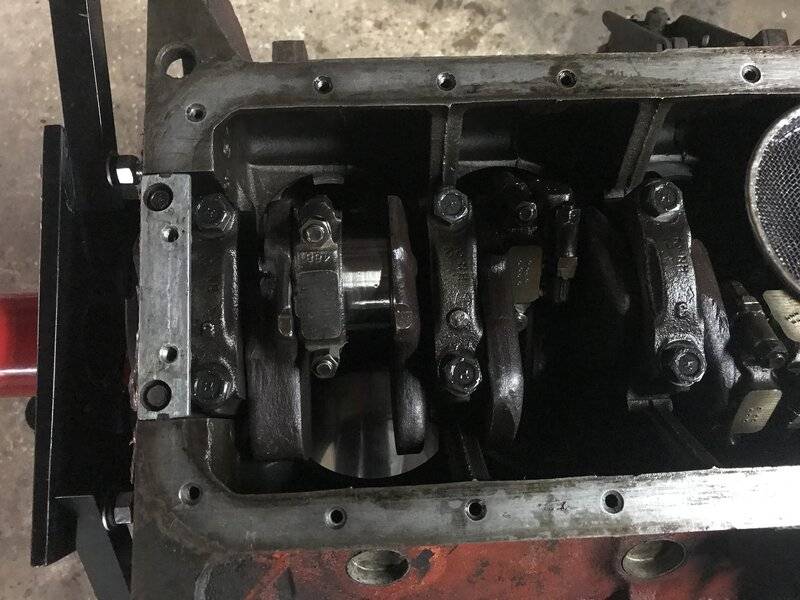

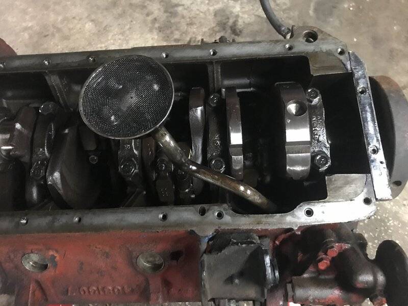

Sadly someone had a problem with #4 cylinder and put in an aftermarket piston that was not even close to spec and it tapered the cylinder so bad my machinist had to do .40 over on the block. He said without that he could have gone .10 over
The crank and rods are still standard bearing size.

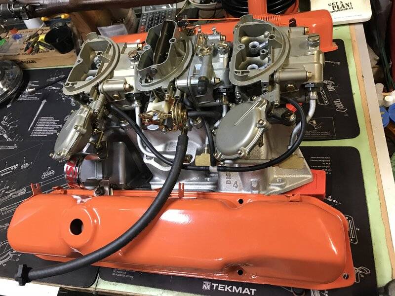

Well my machinist's first words were " There's trouble " and my mechanic neighbor said "problems with bad gas mileage to go along with it " so I compromised and went with a 2 bbl for economy and an extra 4bbl's for power.
Oh and forgot to add I found a good pair of 915 heads and had hardened seats put in so I will use them on this engine instead of the 516's that were on it

It's stamped for a 1970 St.Louis built car, that's about all you can tell. The history guys may be able to hazard a guess as to the model based on that and the HP stamp..
Thanks for finding that !
What exactly is that for ?
I do have a little mechanical knowledge but have never heard of that before.
Back in the lean burn days Chrysler supplied the dealers with a lean burn analyzer. It had a timing probe that went in that hole. The probe was then stationary allowing a tech to analyze and adjust as needed. It was a POS and no one used it.
