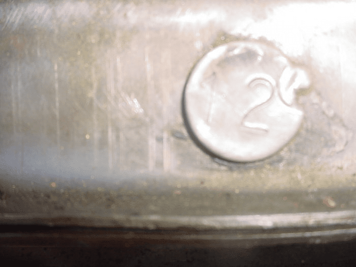

The 'coin' welded on the front relates to the Part Number .... not the date code. Two-digit number equates to the last two digits of the correct part number.

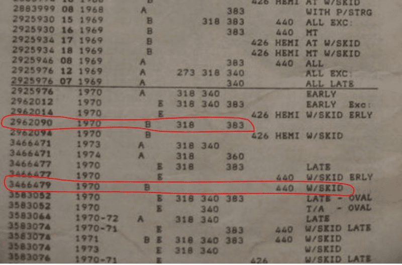

Thanks and you are right about the part number. He was asking about a 1970 6 pack and if I remember correctly the 1970 B body 440 w/skid plate only used 1 number (Nickel) which was 79??
To the average Joe, they are not worth much. To someone restoring a six pack car and has to have that piece to make it perfect, its priceless.
Correct on the '79' coin for a 440-6 pack/6 BBL car....notice the last two digits in bold...
Typical 'coin' welded on the front driver side - most I have seen are upside down. Must be either how the frames were presented at the time, or just totally random how the guy welded it in the first place.

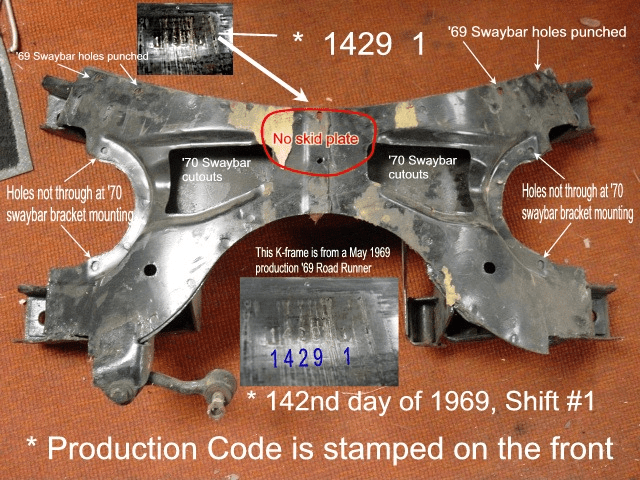

Some more info I found (my books are temporarily in storage)...pictures grabbed/borrowed from FEBO ....
