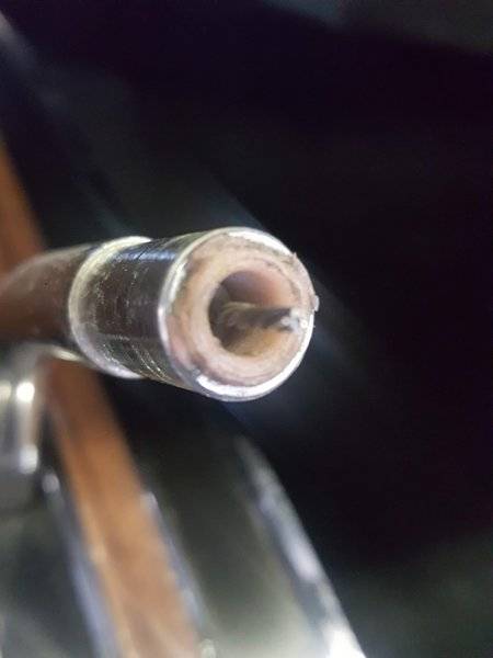

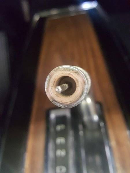

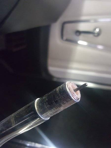

Hi Jim, thanks for responding. Yes that's what I thought but the threaded cable on the shifter side is recessed and I can't get to the threaded portion before the shifter knob bottoms out on the collar.
When screwing both in with the button totally depressed it doesn't seem to reach the threaded portion. Something isn't quite right.
When I got the car the black button had a small screw in it to make contact with the shifter. Instead of being threaded into it. So the previous owner had the same problem at some point.
I will try to take a close up picture soon.
Tom
Maybe tomorrow I will try to just screw in the black button without the shifter knob and see if that even works?
I tried screwing the black push button on without the shifter knob and it doesn’t reach down far enough to screw on.
I think the shifter threaded section is short. Maybe the tip snapped off?
Or perhaps the threads in the black button are stripped.... Seems more likely...
