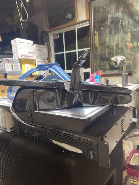

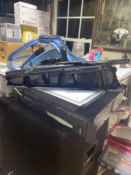

I have two sets of seat tracks and I want to make sure I use the correct pair for my 1970 GTX bench seat.
The pair on the right were in the car when I got it and I think they are the correct ones. Black adjuster knob.

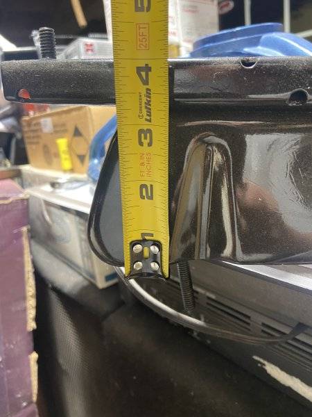

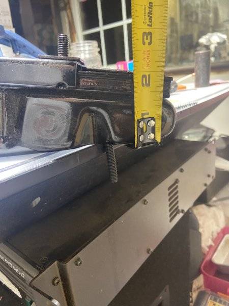

They range in height from about 2 3/4" to 4".
The other seat might be C Body? Chrome adjuster knob.
They range in height from about 3" to 5".
The studs are in the same places on each set.

If you had the measurements, that would be great. I'm pretty sure the taller, chrome knob set came off a C-body seat I came up with years ago. The shorter, black knob set were on the bench seat that was in my GTX when I got it. It was the wrong seat, with no fold down armrest, so I wasn't sure if those were the correct tracks for a 70.
