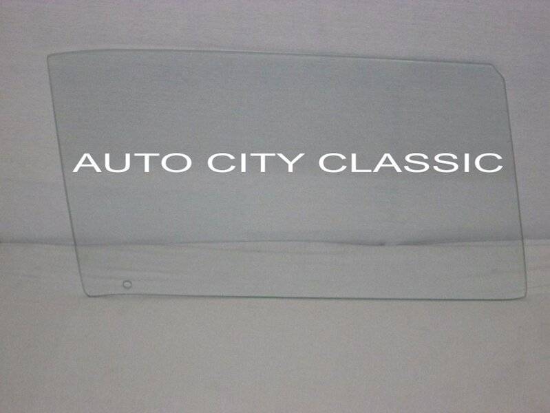

Well it appears that they don't make new driver's door glass for convertibles anymore, so I need a good "clear" driver's door glass that isn't scratched to heck.
Can you post a pick of the glass you need? I may have it

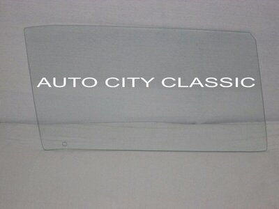

It looks like a mirror image of this one, which is the right side.
Somehow that glass doesn't look correct for a '70 model. First of all, it should have a stainless molding on the rear edge. Second, IIRC, that year uses a 4 hole glass which is the same as what was used in '69 too. I believe the '67-8 has the same shape, but, only 3 holes. I never parted out that many convertibles, so, maybe my memory is hazy. :) The straight interchange is '69-70 B-body convertible only. If you can get a '67-8 glass to work, they also were the same on the hardtops in '67. Good Luck! :thumbsup:
