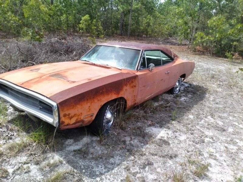

Congrats and you can get over 4oo hp out of that 318. I bought a 70 Charger last year and want to stroke the 318. You could pull it and drop a 383 or 440 if you want a big block. I want to keep my car original and everyone has a BB in their chargers.
