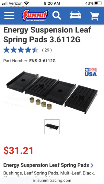

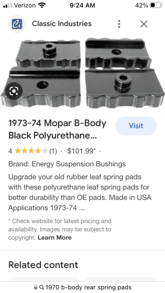

Help - I am trying to find leaf spring pad for my 1970 charger. 8 1/4 rearend. I have found energy suspension pads for 1972 and up. But appear to be much different than what I need. Any suggestions would be much appreciated. I also found GM ones at summit, but can’t locate the ones I need.
Thanks very much

No axle in the '70 models used rubber isolator pads. The rubber cushioned stuff appeared in 1973.
Well that explains why I can’t find one:) would you recommend putting something in it? Or do you feel it will be fine…
