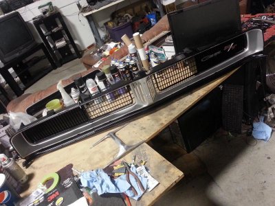

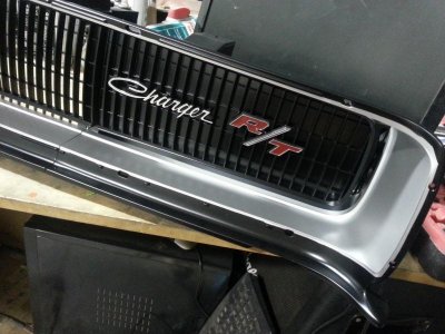

Also I'm starting to do grille restorations for people, if you'd want me to do yours just shoot me a message. Here's mine that I'm finishing up

Still waiting to get the car back from having the frame pulled. In the mean time here is the grill, getting real close to paint:
from this
to this
and lots of work in between!
