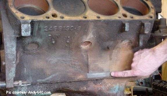

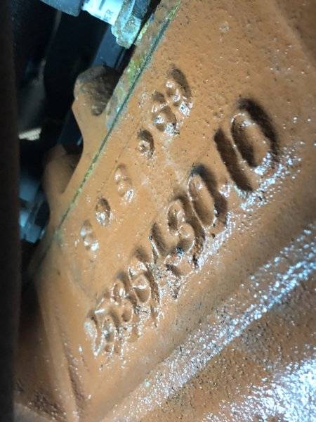

On the block that's the casting number not the serial number. There should be a spot ground flat with the serial number punched in it.

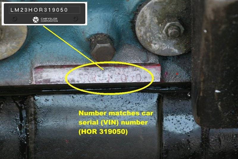

Passenger side near oil pan rail. Should have year, assembly plant letter, then the last 6 digits of the VIN that matches the car it came from.
:thumbsup:

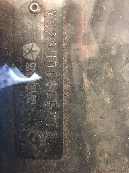

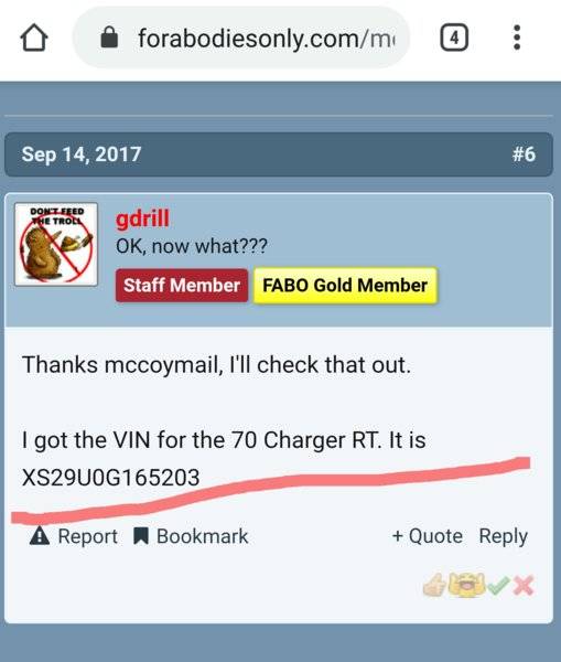

On the right side of the block, just above the oil pan, you should see 0G165203. If that area is blank, then you have a warranty block or a service block.

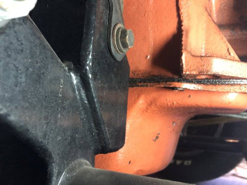

Shouldn't be. Should be able to see it with a light on a lift maybe.

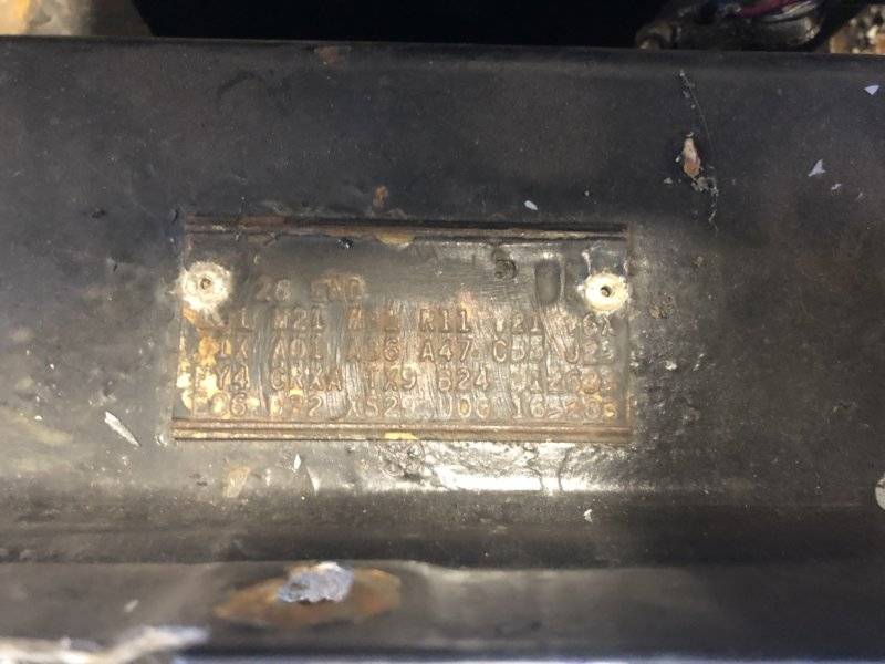

The car build date on the fender tag and the cast date on the engine block make it a good prospect for matching numbers, or should I say matching engine. Look closer for the VIN# on the passenger's side pan rail.

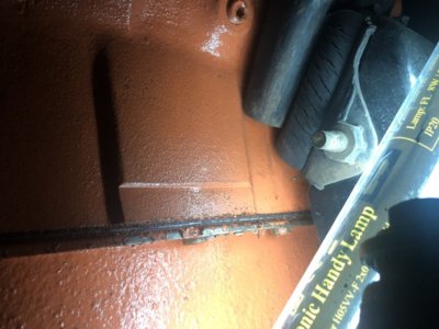

I took a pic of where i think it supposed to be, but its blank.
So its probably a replacement block ?
