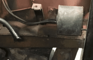

I have a 70 charger with 383 and ac i bought as a basket case. I am about 70 percent back together and am stumped where the vacuum can Should mount. I did get one with the car and there is two vacuum lines coming out of the firewall. The short one goes to the water valve but the other hose is long enough to make it to the core support almost. I have seen people say maybe under the battery tray but there isnt a bolt hole configuration that matchs the can. My first post all help appreciated. Thanks Harry

The big vacuum can on 68-9 Chargers was for the headlight actuators... But the A/C canister did mount under the battery tray..
Wild RT, that is exactly what my can looks like so will have to look under battery tray again. Does the hosethat goes to the engine go to a direct vacuum port or somewhere on the carburetor. Thanks again
The fitting on the back of the manifold where power brakes (Assuming you have power brakes) connect should have a small vacuum connection...
