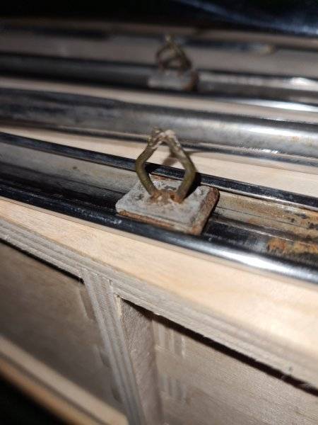

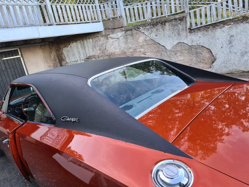

So i got a new vinyltop mounted on the car now cause the old one wasnt good enough, so i wanted to ask you guys/gals if the clips on the trim that goes just below the Charger emblem needs som sort of seal? I think i have seen it before but i could be wrong =P

There was foam seals from the factory ones have none. I used 3M strip caulk to seal mine.
