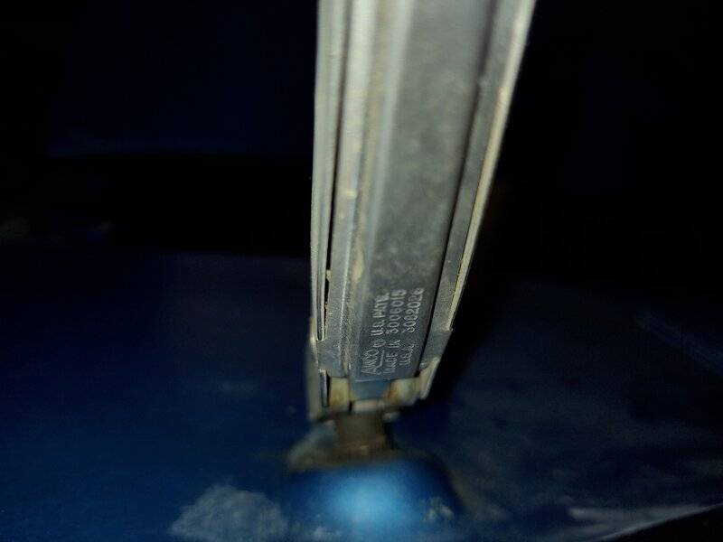

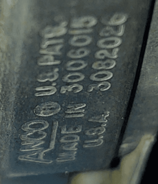

The left and right pivot arms on my '70 Charger are marked/stamped "15B".
Both of my wiper arms measure around 13-3/8" to 13-1/2 from the (splined) pivot point to the slight dogleg near the wiper. Very difficult to measure, but the part numbers on both wiper arms are the same. Part number is on bottom side of arm down near the splined pivot.
However, the metal housing that hold the rubber wiper blade are different lengths.
Driver side metal housing length: 15"
Pass. side metal housing length: 14"
__________________________________________
15B
Driver
Passenger
PIVOT ARM
Driver p/n: 3082026
Passenger p/n: 3082026
Difficult to read (trust me, same p/n as driver p/n)
CLOSEUP (all info)
Metal Blade Housing
Driver (15" measured)
Passenger (14" measured)
