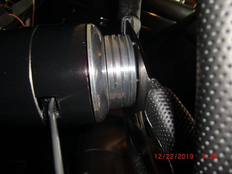

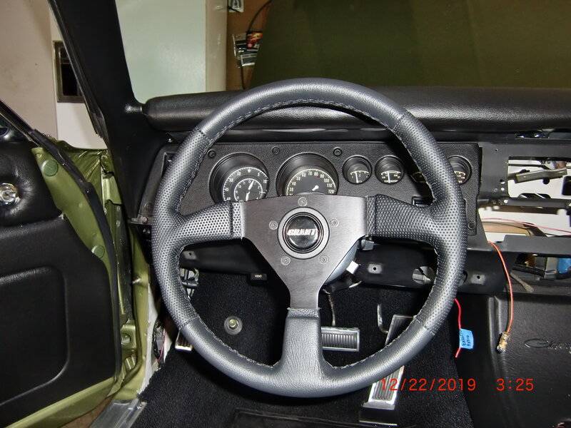

Tim, It's been a couple of years since I did it and at the same time I was changing out the shift housing as I had moved the trans shifting from the column to a center console. I also opted for one of Grants premium sleeves behind the steering wheel. A couple of photos attached. Like I said it's been a couple of years and I don't remember every detail but the whole change over went without any problems. Hope this helps.
