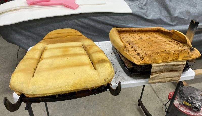

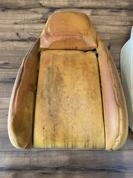

Working on replacing the seat foam and seat covers in the 70 Super Bee. Legendary sent us these foams. I think they are for a Charger. I know they don't make a specific foam for the Coronet front buckets, but I don't think I can make these upper Charger foams work. I think I can get the new bottoms to work, but that will be a chore. My main concern with the new charger foam is the upper headrest area seems too shallow. I don't see how that will work. What have you guys had success with? Appreciate the help.

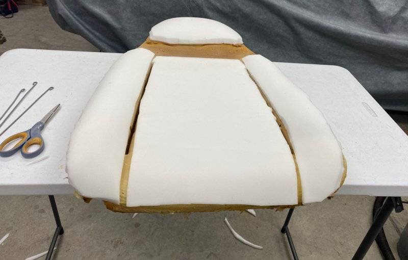

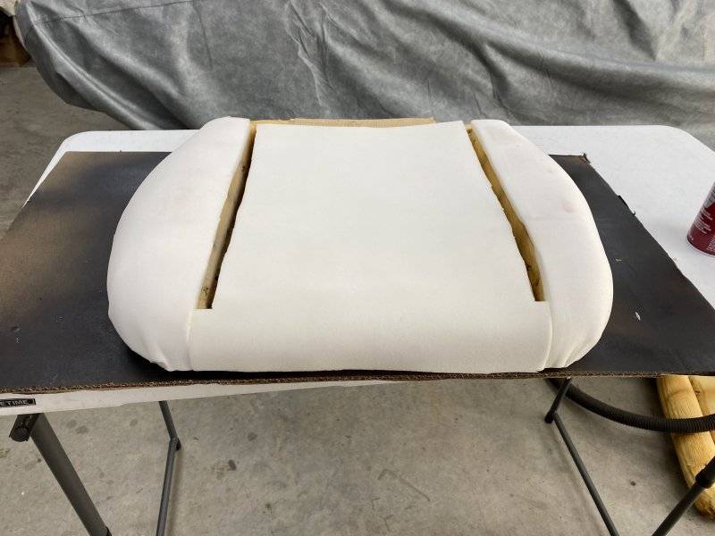

Your original foam looks reusable. I started with foam in about the same condition. Some 1/4" and 1/2" quality high density foam to fill and firm up the needed areas helps the covers really fit well. 3M super 70 to attach the foam and install your covers.

That's a good idea. Looks like it work well for you. I'd feel good doing something similar to the ours. The pictures I posted are the passenger side. Unfortunately the drivers side is in much worse shape. Your original foam is slightly different. It's crazy how many different seat designs Mopar had just in the 1970 year. No wonder they don't reproduce them.
I'm reupholstering the high-back buckets in my 1970 Coronet. I have seats from 2 cars, and between them, I have one pair of usable foams. I'll do a 3-D scan of the foams before I put the foams in the seats, and I'm thinking about how new seat foams could be formed using the 3-D scans. I wonder how many people would be interested in getting new seat foams for a 70 Coronet. Would it be worth the effort to work out the process?
