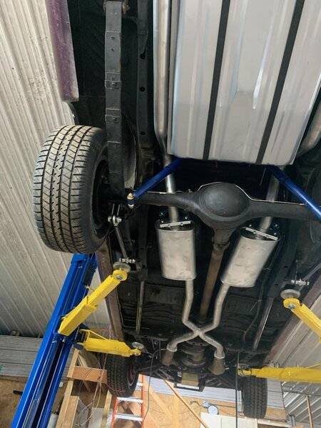

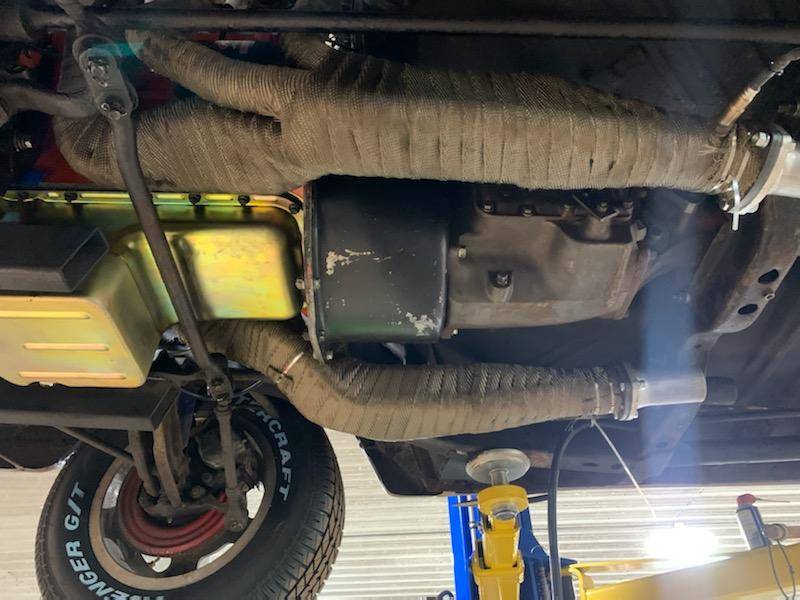

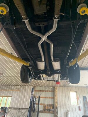

Look at TTI
I put a complete TTI Exhaust on my 69 b body (Mine has a 440) , headers to tips and fitment is the best I have ever dealt with, I had to do NO adjusting or clearing at all and my headers are wrapped. Just head to the TTI website. Very easy to find your application. Hardest part is pushing send when you have your credit card entered..

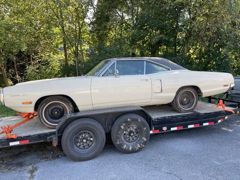

Tell us more about that car. It looks pretty clean and solid.

thanks for all the advise! I have to get some more pictures posted. I have a million ideas but still trying to decide what exactly what all i am going to do to the car. It is a really solid unmolested 37k original mile car. I'm not looking to race, just want it to look good, sound good, and maybe spin a tire once in a while.
