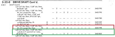

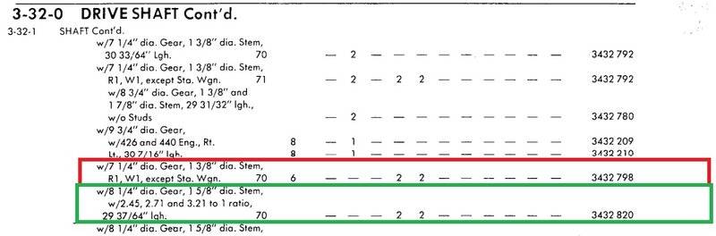

WTB 1970 driveshaft 318/auto
I took one out of a 1970 b body 318 ,904 with a 8 1/4 rear not sure if it is the same
doesn't look like it will work. different "stem" diameter
Chris, You are on the wrong path with the parts book. If you need a 'driveshaft' ie a propellershaft you need to spec lenght and U joint size. That is all. The PB 3-31 describes rear gear pinion shaft diameter. It does not determine the flange U joint size. yes it related, but not the key bit of info needed.
Just like Desotoman wrote... I have few nice used driveshafts here, but they came out of cars with the 8.25 rear. I am sure, that if you measured from the axle centerline of an 8.25 to the C of the u-joint on the yoke, the length of the 8.25 would be longer in length, vs the 7.25 rear. As far
as the rear u-joint in the 7.25 rear it would be the small joint (7260). I myself have never seen a 7.25 rear come stock in a B-body car like the original poster needs. All the ones we have parted, have been 8.25 or 8.75 rearends
Chris, I have one from a 67 Coronet 318 car, not sure if that works for you
