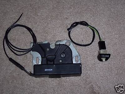

Does anyone have a diagram for the 1970 factory vacuum trunk latch. I'm looking to install one on my GTX. Can't find where to take the vacuum from for the latch.
The vacuum comes off the intake manifold nipple. If you have power brakes, the ideal piece would have a big spigot for the power brakes and a small one for accessory vacuum. There will be a small vacuum resevoir with this system as well to allow a couple of releases without the motor running. I added a system from a Chrysler to my '67 R/T, but it never really worked very well. The better one is the later Chrysler electric one.
Yes....the electric release mechanism as used on the 1970 C bodies (Chrysler 300 Hurst, Dodge Polara, possibly Plymouth Fury III, etc) operated so much better as the vacuum line and hoses from the release button thru the trunk hinge joint was prone to leakage.....just my opinion of course...

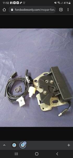

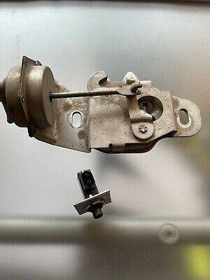

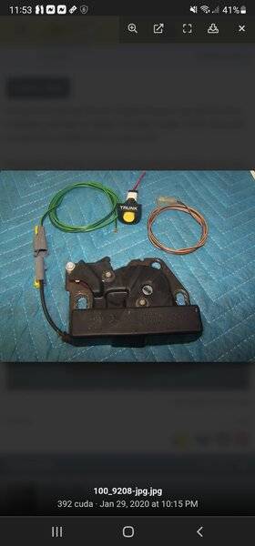

I have been told the mid to late 70 electric work perhaps more reliably than tge vacuum and still fit my 1970 GTX. See attached photos

I do not have an electric one, but I agree they work better. You can likely find one in junk yard late 70's New Yorkers.
