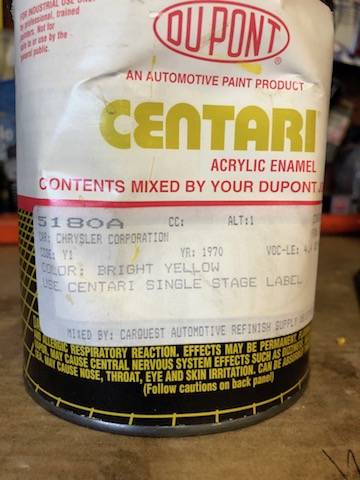

Take the can and have them scan what’s left in the can if possible or on the lid ...they use a hand held scanner that does pretty good if there is some in there , if not get many small samples for spray out cards as I’ve seen lots of variations and it may depend on the fella mixing it.

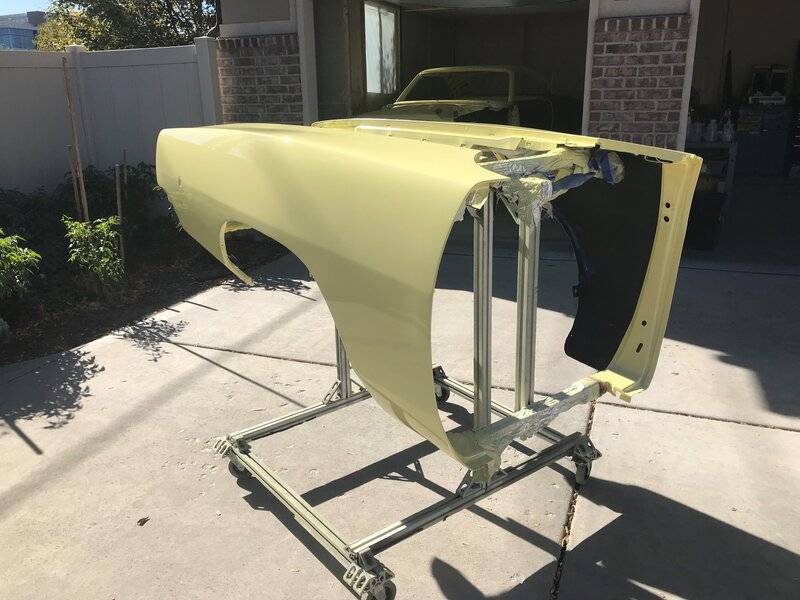

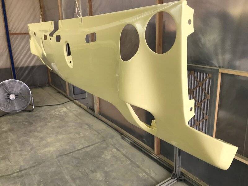

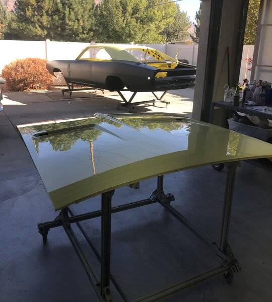

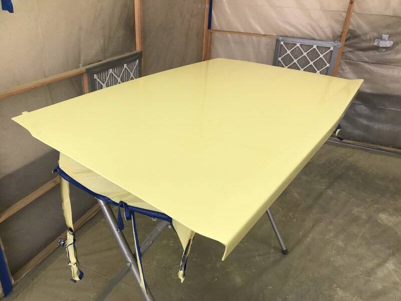

For what it is worth I will be spraying PPG Deltron Top Banana/Lemon Twist this Monday if all goes as planned. You can check out the color then if that is your concern. Just let me know and I can send you pics.
Good luck on spraying it hope it matches , sprays well! Not being a smarty pants either!
